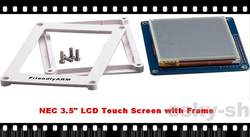

Judging by the size of the lower portion, I'd say he is planning on cutting it down. The bottom pictures show the demo board size bottom... but the tops appear to be from the Radio Shack cases, with a window cut in them.
Also, Chuck said he can do custom work if you want it. I am going to have him do some for me.

http://www.esky-sh.com/ebay_gallary/3.5/show2.jpg
Chuck at Mountain King Technologies replied with pictures of handsome bezels/cases - he just has to price them.

OK - see two attached pictures
Forrest
I want the bezel to be say 1/2" max around the display.
