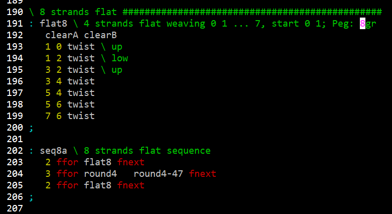

  • I have posted the actual version of P2XCForth. https://forums.parallax.com/discussion/176239/p2xcforth-a-fast-hybrid-xbyte-and-c#latest Control of PropellerBraider is done with this Forth, see Block50. One of the nice things about Forth is, that you extend this language. So now for example there is a new command "home", which lets the machines step motors go to the start position. You can type this into the terminal or you can use the new word in a new program. So the description of a breading pattern is a program, that can be compiled and executed. You don't need to write an interpreter, it's already there.
    \ 8 Strands #K376 Round #####################################
    : round8 \ Startbelegung 0 1 4 5 8 9 12 13
       clearA   clearB
       0 10 moveA   8 2 moveA
       12 6 moveA   4 14 moveA
       9 3 moveA   1 11 moveA
       5 15 moveA   13 7 moveA
       2 slotA   0 setSlotA
    The last line here sets the former bobbin position number 2 to be number 0 from now on.
    So evoking "round8" will do one cycle of movements.

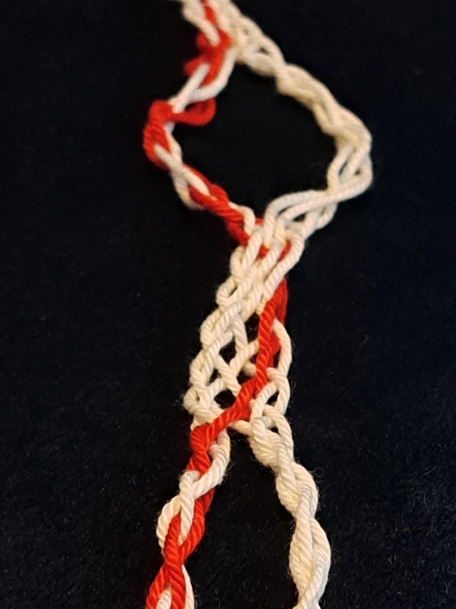

    So, how often can I fall into the same pit? After I activated yarn tightening of the second pickup spindle the system failed and also crashed! But not really repeatable after some time after start. - I searched for some strange stack overflow or something? Electric pulse from switching off a motor? In the end it was overheating of one driver module due to higher voltage for the higher speed in combination of hot room temperatures. (Solution was to switch over to the TMC2209 for all axis. Current is now reduced to 0,53A for all axis.)
    Found some Cotton Yarn "Gruendl Cotton Quick uni" 250m/100gr mercerised, gased, combed, which has some nice gloss. I think the strength of this yarn fits well for this machine.
    Picture shows a sequence of patterns with 8 strands, 6 white and 2 red. A section of woven style for all 8 strands is followed by 2 parallel "Kumihimo" style round breads for 4 strands each. I think, you can call this sequence "lace". The woven part is an "allowed" pattern for "Kloeppeln" braiding lace, as it only consists of twists of neighbouring strands.
    One nice thing about using Forth for such project is, that you can easily create your special description language. Here we can see, that "flat8" first brings the two pickup spindles in secure height and then does 7 twists. A twist is a series of movements, which swaps two yarn spindles.
