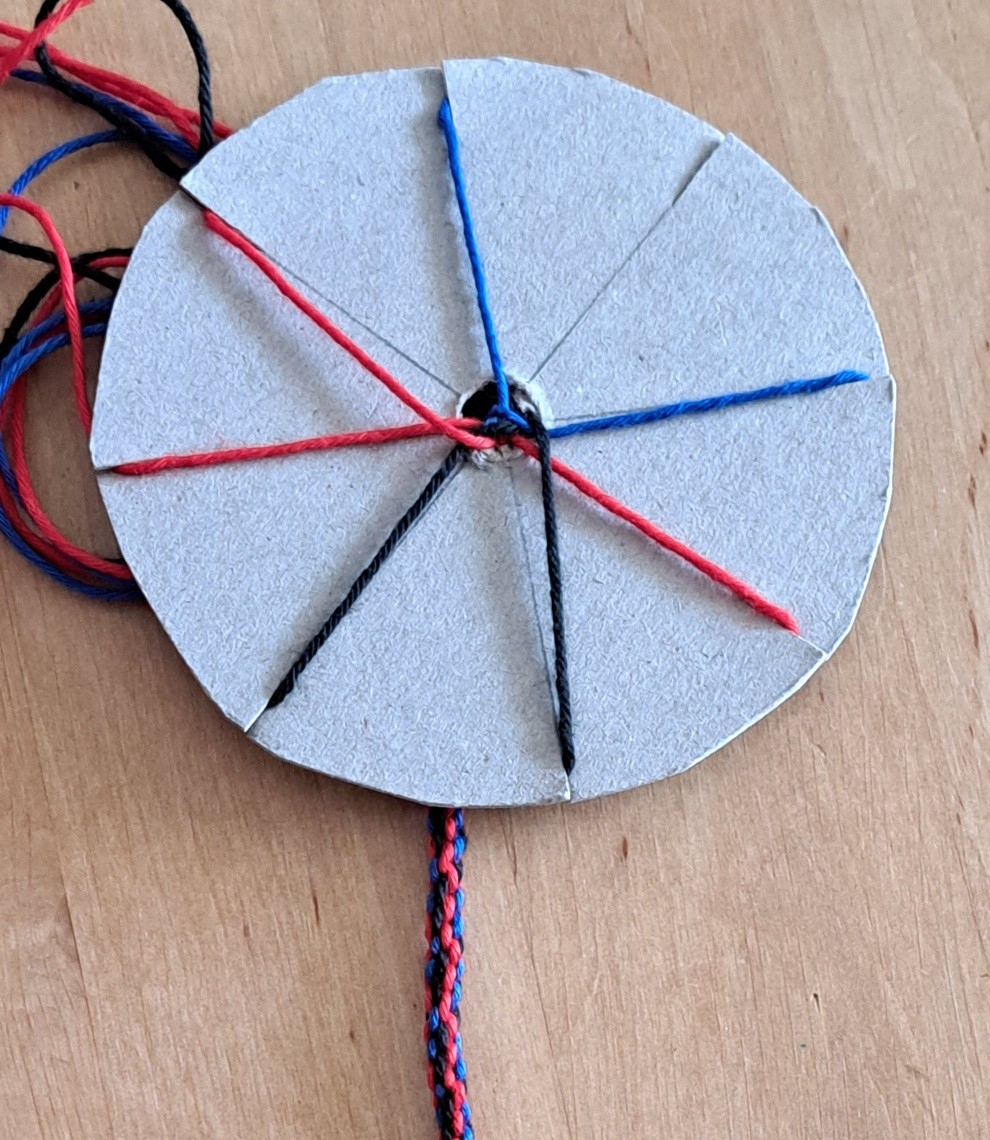

This picture shows a my very basic means to do a braided cord:
A nice German pdf about this can be found here: https://www.regensburg.de/fm/RBG_INTER1S_VM.a.253.de/r_upload/Onlineprogramm - Freundschaftsarmband.pdf I have learned, that this method is called "Kumihimo". (Actually the way of braiding used here without twists is rather special. It is funny: I have tried to vary the number of strands from 7. But this is the only number that works in this way! Some sort of miracle.)
It shows some basic principles of the way, I want to go here:
  • Have some strands of yarn, maybe with different colours
  • Each strand will be held on a bobbin
  • The bobbins sit on positions on a round plate.
  • The fabric or cord leaves downward through the middle of the plate.
  • Tension is controlled while moving bobbins.
  • Movement of bobbins is not radial but vertical to the plate and in circumferential direction. (I hope, this keeps the question of tension more easy)
  • The plate is rotated during work.

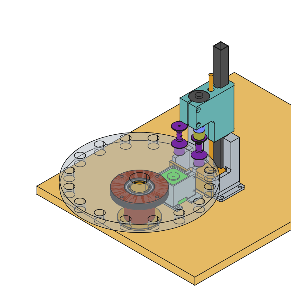

For my design, I have decided to split the movements:
The plate with the holding places for the bobbins will rotate and therefore I will call it carousel. A pickup-spindle can grab the bobbin with an electromagnet, has the ability to rotate the bobbin to tighten the yarn and can lift the bobbin.
There will be two pickup-spindles to be able to swap two bobbins more easily.
The idea is to be able to have the possibility of a larger carousel, but to begin with a smaller one. (Have a limited disaster, if it does not work....)
So, here is a picture of the current design, only one pickup-spindle shown:
Diameter of the carousel with 16 positions is about 300mm.
There are:
3 step motors, one for rotation via belt drive and 2 for lifting
2 DC motors for the tension and
2 electromagnets.
A 4th step motor will be used to wind up the cord. (Not shown)
I think, that for this project, to have a P2 controller with 8 cores is quite helpful. The actuations are related but not like Bresenham in one movement.
As said before, at the moment this is all theory. I have begun to produce first parts. I don't know, if it will work. :D:#:D
One bigger question is, if the electromagnet will hold and also let go the spindle. It is D20x15mm and said to hold 2,5kg in ideal cases. For solenoid armature, fixed to the bobbin, I hope a steel washer will work. ??? I will provide means for AC voltage and PWM.
Perhaps some comments, ideas?
