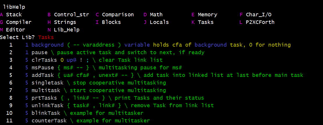

    An update:
    P2XCForth has been used for my Embroidery machine and also now for for the PropellerBraider. For these projects I have used the onboard forth editor FED.
    Besides I have introduced the Library System. This online help lets you first choose a Library, which is a group of words belonging to a topic. It then displays the first lines of the definitions of it's words. From FED you can choose a word to be inserted at the cursor.
    To get started on a kiss board (25MHz crystal), you can copy _BOOT_P2.BIX and blocks.blk onto a SD card. For other boards you will have to recompile. blocks.blk also contains the source blocks for the embroidery machine and PropellerBraider. As is!
    Cheers Christof
