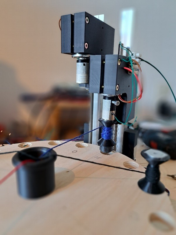

So, here is a picture of the current design, only one pickup-spindle shown:
Diameter of the carousel with 16 positions is about 300mm.
There are:
3 step motors, one for rotation via belt drive and 2 for lifting
2 DC motors for the tension and
2 electromagnets.
A 4th step motor will be used to wind up the cord. (Not shown)
I think, that for this project, to have a P2 controller with 8 cores is quite helpful. The actuations are related but not like Bresenham in one movement.
As said before, at the moment this is all theory. I have begun to produce first parts. I don't know, if it will work. :D:#:D
One bigger question is, if the electromagnet will hold and also let go the spindle. It is D20x15mm and said to hold 2,5kg in ideal cases. For solenoid armature, fixed to the bobbin, I hope a steel washer will work. ??? I will provide means for AC voltage and PWM.
Perhaps some comments, ideas?

    An update: It's braiding! B)
    So far I have done braiding with 3 strands and now round braiding with 4 strands, Kumihimo Style.
    Have had big problem to 3D-print larger parts from ABS. Awful warping and cracks. A different type of ABS solved this. This even led to a failing main bearing unit....

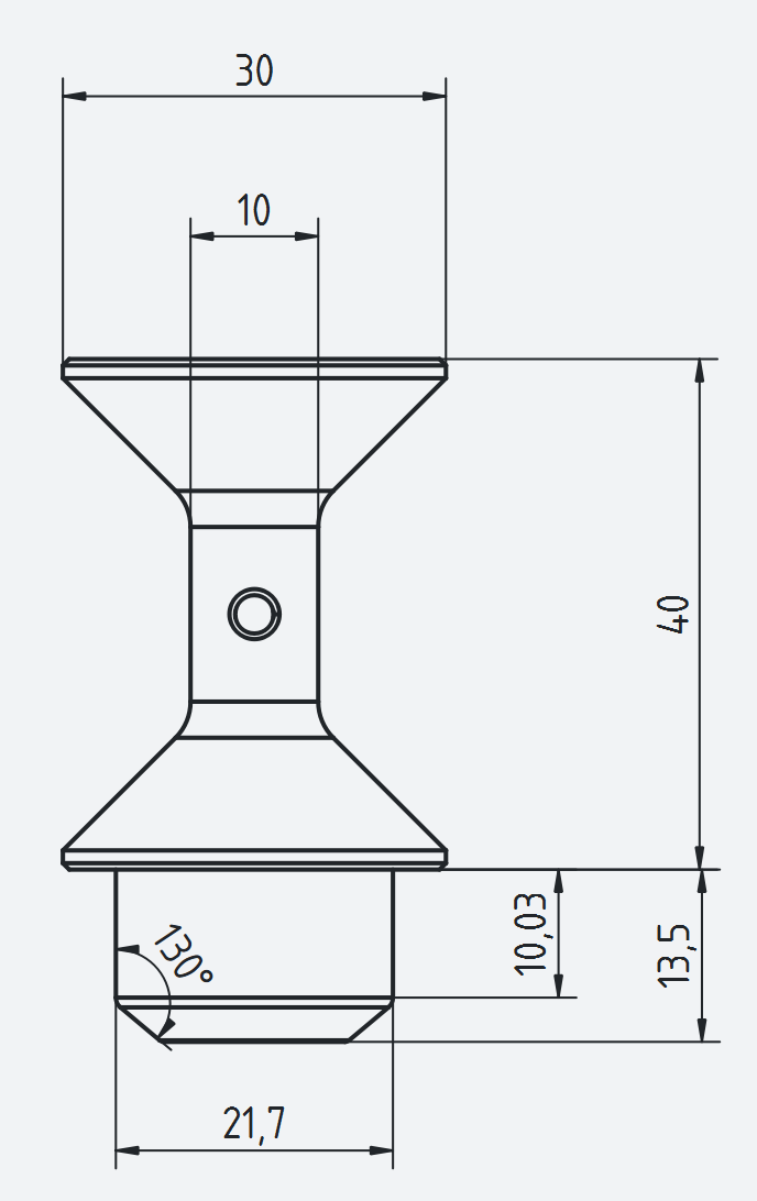

    Second difficulty was to find the right shape of the chamfer at the lower end of the bobbin. When the bobbin is put down onto the carousel, it's position shall be realigned. The chamfer leads it then. The picture shows the bobbin. The carousel plate is 12mm thick. The chamfer of the bobbin is also sanded for low friction. The chamfer must allow sufficient variance of position, must not stick when the bobbin is put down and the length of the cylinder must not be reduced too much. Under the carousel there is the belt drive wich must not collide.
    At the upper end of the bobbin a steel washer is glued to the face. To prevent sticking two layers of Tesa film adhesive cover the washer and form a magnetic gap.
    The braiding point is now elevated from the carousel plate, which decreases variation of tension. The tensioning motor is not used. Yarn tension is so low, that the motor is not moved, even with no motor current at all.
    To pull down the braided cord, a peg with weight of about 8,5 grams is attached to the knot at start. When the bobbin is moved down on the carousel, the yarn tension is high and then sometimes the bobbin spins a little bit to release perhaps 1mm of yarn.

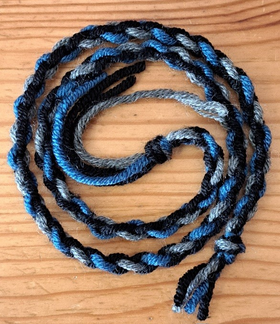

    And some "product":
    This is acryl wool. Diameter of the picture is about 8cm. I am quiet happy, that the braid has this good regularity. This is very sensible to the tension when the bobbins are wound.
    Cheers, Christof

    The braiding point is elevated some more, which gives better consistency and also makes the braid more dense.
    Two variations of the same 8 strands round Kumihimo. You can vary the pattern, if you have different colours at different bobbin positions at start. https://friendship-bracelets.net/patterns/kumihimo?SortBy=&MinColors=&MaxColors=&MinStrings=&MaxStrings=8&MadeByUser=&Keywords=&SimilarToPatternId=&OnlyPatternsWithPhoto=false&OnlyPatternsWithVideo=false lists 80 "proven" nice patterns with 8 strands. This site also has a design tool for patterns.

    Yet another shape of the bobbins. The issue with the former type was, that the thread can get stuck beneath the upper flange, so now there is a modified angle there of 155 degrees. Also the diameter 10mm was increased to 15mm. Idea is, that the tension of the yarn can turn the bobbin in it's bore D22 more easily.
