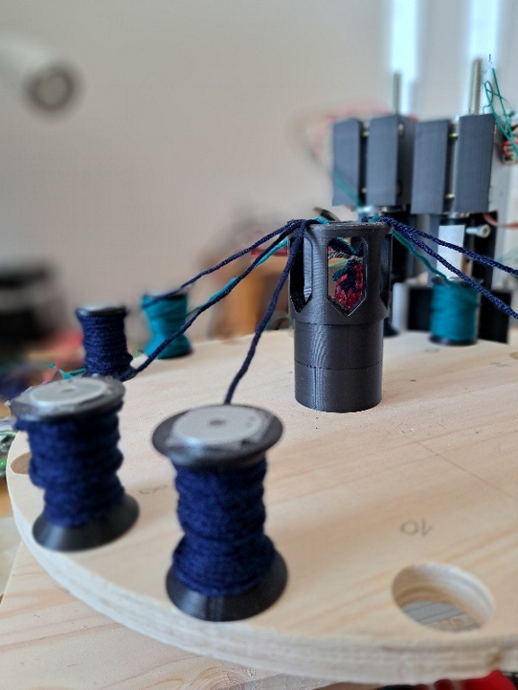

For my design, I have decided to split the movements:
The plate with the holding places for the bobbins will rotate and therefore I will call it carousel. A pickup-spindle can grab the bobbin with an electromagnet, has the ability to rotate the bobbin to tighten the yarn and can lift the bobbin.
There will be two pickup-spindles to be able to swap two bobbins more easily.
The idea is to be able to have the possibility of a larger carousel, but to begin with a smaller one. (Have a limited disaster, if it does not work....)
So, here is a picture of the current design, only one pickup-spindle shown:
Diameter of the carousel with 16 positions is about 300mm.
There are:
3 step motors, one for rotation via belt drive and 2 for lifting
2 DC motors for the tension and
2 electromagnets.
A 4th step motor will be used to wind up the cord. (Not shown)
I think, that for this project, to have a P2 controller with 8 cores is quite helpful. The actuations are related but not like Bresenham in one movement.
As said before, at the moment this is all theory. I have begun to produce first parts. I don't know, if it will work. :D:#:D
One bigger question is, if the electromagnet will hold and also let go the spindle. It is D20x15mm and said to hold 2,5kg in ideal cases. For solenoid armature, fixed to the bobbin, I hope a steel washer will work. ??? I will provide means for AC voltage and PWM.
Perhaps some comments, ideas?
Have fun, Christof

    An update: It's braiding! B)
    So far I have done braiding with 3 strands and now round braiding with 4 strands, Kumihimo Style.
    Have had big problem to 3D-print larger parts from ABS. Awful warping and cracks. A different type of ABS solved this. This even led to a failing main bearing unit....
    Second difficulty was to find the right shape of the chamfer at the lower end of the bobbin. When the bobbin is put down onto the carousel, it's position shall be realigned. The chamfer leads it then. The picture shows the bobbin. The carousel plate is 12mm thick. The chamfer of the bobbin is also sanded for low friction. The chamfer must allow sufficient variance of position, must not stick when the bobbin is put down and the length of the cylinder must not be reduced too much. Under the carousel there is the belt drive wich must not collide.
    At the upper end of the bobbin a steel washer is glued to the face. To prevent sticking two layers of Tesa film adhesive cover the washer and form a magnetic gap.
    The braiding point is now elevated from the carousel plate, which decreases variation of tension. The tensioning motor is not used. Yarn tension is so low, that the motor is not moved, even with no motor current at all.
    To pull down the braided cord, a peg with weight of about 8,5 grams is attached to the knot at start. When the bobbin is moved down on the carousel, the yarn tension is high and then sometimes the bobbin spins a little bit to release perhaps 1mm of yarn.

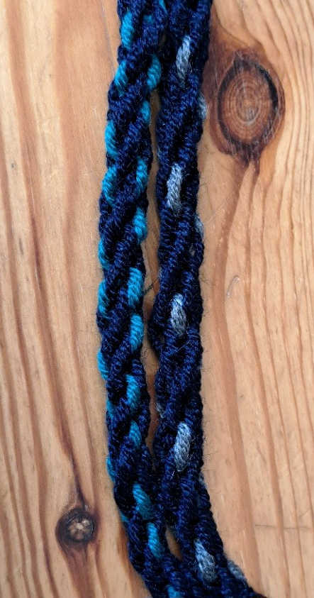

    And some "product":
    This is acryl wool. Diameter of the picture is about 8cm. I am quiet happy, that the braid has this good regularity. This is very sensible to the tension when the bobbins are wound.

    Two variations of the same 8 strands round Kumihimo. You can vary the pattern, if you have different colours at different bobbin positions at start. https://friendship-bracelets.net/patterns/kumihimo?SortBy=&MinColors=&MaxColors=&MinStrings=&MaxStrings=8&MadeByUser=&Keywords=&SimilarToPatternId=&OnlyPatternsWithPhoto=false&OnlyPatternsWithVideo=false lists 80 "proven" nice patterns with 8 strands. This site also has a design tool for patterns.

  • I am still experimenting with geometry of the braiding point. This version has a smaller diameter, which shall give a braid more dense. Last trials have been with a combination of cotton yarn and some thin acryl. Both have very low elasticity which makes things more difficult.
    Also I have now activated one tensioning motor. It sits above the spindle. The electromagnet acts both as a gripper and a clutch. The motor can turn the spindle to tension the yarn. It is driven via a L298 bridge. The motor is rated for 12V but we only use 5V and smartpin PWM to be able to fine tune torque. This setup works. :-) However the actual diameter of the spool has influence on the tension. Well, that's mechanics....
