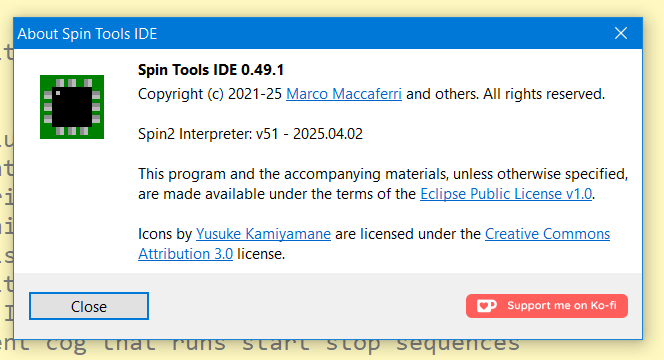

  • Marco,
    just a reminder: in the help/about of the latest version (0.49.1) the shown version number is 0.37.0 while it is correct in the file properties
    Regards

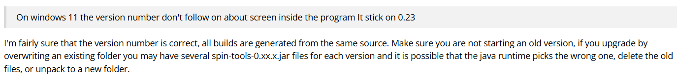

  • JonnyMacJonnyMac Posts: 9,829
    edited 2025-09-28 15:27
    You may need to do a clean install. I'm on Windows so installing is a simple unzip process, and I always do this into a separate folder for each version (which only take about 85MB of disc space). I keep one or two earlier versions in case something big pops up (though it usually doesn't).
    After my morning walk I used ChatGPT to find the answer Marco provided to someone else. You can find it in post 256 of this thread.
  • Thanks @JonnyMac
    That was the case ... I unzipped the files in the same folder (because I have many links pointing to the folder structure of my R&D tools)
    It was easy to delete the files from the lib folder because Marco timestamps them all with the same value.
    ... and YES this is happening on Win11 only, because on my other machines I didn't noticed this behavior before.
    Regards
    Dario

    Had a strange version problem like the above...
    Copied new version on top of old. It complained about IDE being open, so closed it and then did "Try Again".
    That worked but actual version didn't update...
    Not sure how that can be...
    Guess need to delete the old version to make sure it copies over correctly...

  • maccamacca Posts: 1,054
    The problem here is that the jar files that compose the runtime are read in "directory order", this means that depends on the OS and how it reads the directory list, Linux should always read in alphabetical order so, since jar files are versioned, a file named spin-tools-0.49.0.jar comes before the updated file named spin-tools-0.49.1.jar and takes precedence. Other OSes may read the directory in different order, not sure how NTFS works these days.
    Yes, I'll try to set a fixed list of jar files to read to avoid the version mismatch, but for now I suggest to always delete the old spin-tools directory and unpack the new version (make sure to not have any work files in there). Configuration files are not affected since they are stored in the user's home directory.
