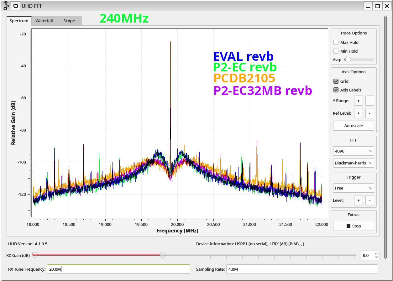

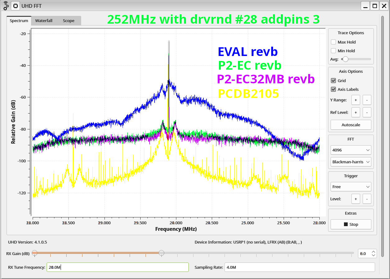

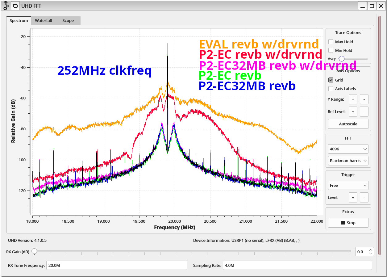

  • I was wondering if this would affect my radio transmitter code. It certainly does. An FM signal turns to static on affected boards.
    The P2-EC revb is is better than the eval but also fails when P28-P31 are stressed. The P2-EC32MB revb is unaffected by PLL related issues but a lot of random noise from those toggling pins is coupled into the signal. I could see this in the VGA signal too. I have the breadboard breakout board.

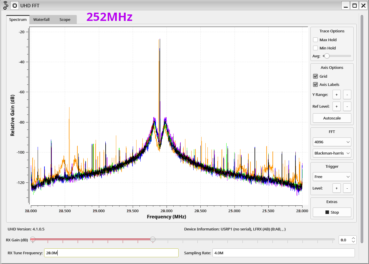

    Is there anything fundamentally wrong with the P2 crystal oscillator? I don't think so. I can't really tell much difference between the P2-EC32MB with oscillator and a reasonable crystal design. Note that the PCDB2105 is a 2 layer board and uses a 24 MHz crystal. It's plot doesn't look great here but the higher crystal frequency is spreading the noise out over a wider area. I'm mostly interested in how high the humps are on each side of the generated signal. If you care about phase noise, use an integer multiple of the crystal frequency. That way the divider is 1 and the phase detector frequency is as high as possible. Changing from 252 MHz to 240 MHz dropped those humps by about 20 dB.

    The EC32MBs were a later design and all its revisions use an external oscillator chip. The Edge-EC revA and revB are similar to Eval but given the improvement in your first graph, compared to the Eval, I'd guess the EC revB, at least, has space between the XO/XI tracks.
    The difference between your second and third graphs backs up a number of other prior observations with VGA shimmering and I've shown it on a scope with clock jitter measuring too. Low divider values are better than high dividers. More specifically, low D divider. High P divider is fine because its outside the PLL's VCO control loop.

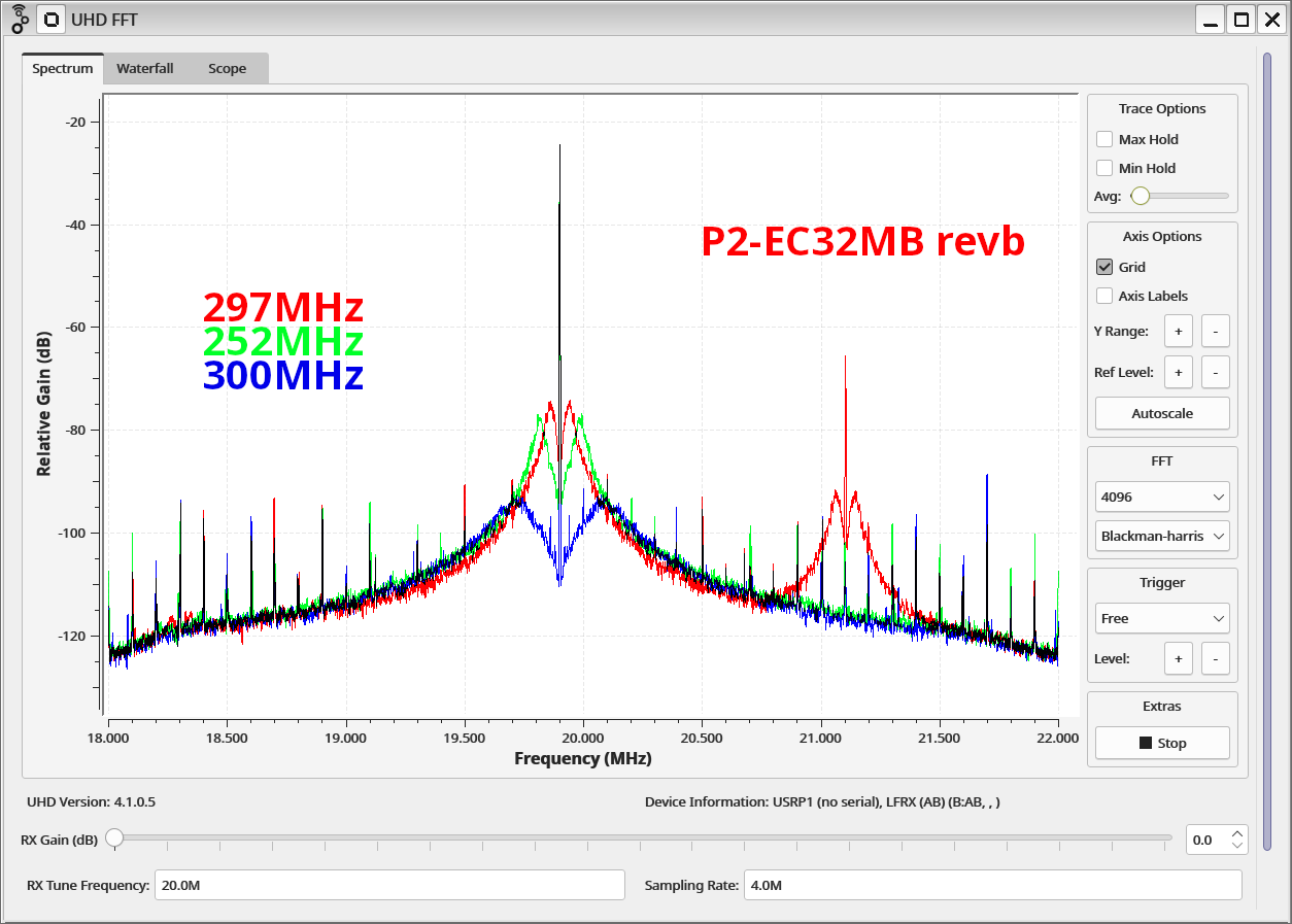

    If we wanted to generate a 1080p signal, the pixel clock is 148.5MHz. Double that and we get a sysclock of 297MHz. Unfortunately I expect the performance at 297MHz to be BAD. For video a 54MHz oscillator would be optimal with 27MHz a close second. 18MHz would work pretty well too. I'll check the phase noise at 297MHz on Monday.
    Note: in my post above, plots 1 and 2 use the same binary regardless of 20 or 24 MHz crystal. So the PCDB2105 is running at 302.4MHz and outputting 23.88MHz instead of 19.9MHz. In the third plot all boards ran at 240MHz which is an integer multiple of both clocks. My choice of 24 MHz was due to having an abundant supply of 24MHz crystals and not due to any PLL considerations.

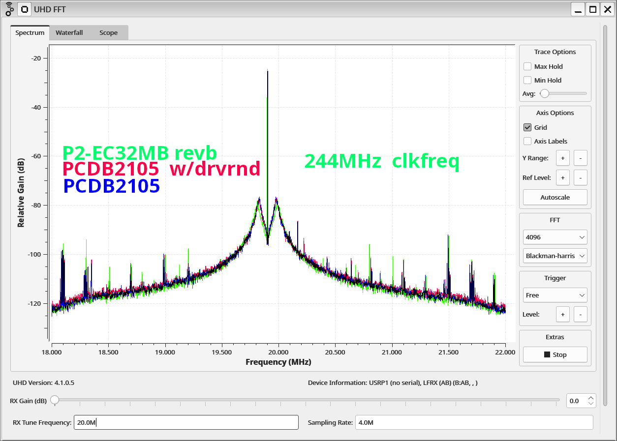

  • With tape over P28-P31. Now we can see what's happening.
    297 MHz is only slightly worse than 252MHz. That is an image at 21.1MHz. 297-19.9 = 277.1 277.1 - (64*4) = 21.1 The USRP1 has a 64MHz ADC clock.
    At 244 MHz both 20 and 24 MHz clocks must be divided down to 4 MHz and then multiplied by 61. Looks like a crystal is fine. Looks fine on the plots and no audible artifacts on the radio signal. I have NOT checked VGA on this board.
