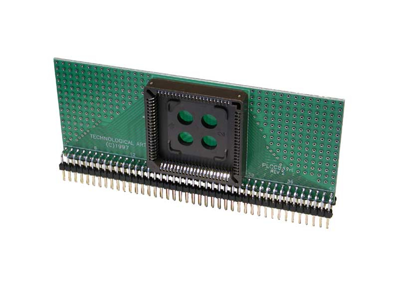

    Here's an interesting thing...
    https://www.technologicalarts.com/products/plcc-adapter-84-pin
    Says the two rows are spaced 0.3" apart, which guess means will work on breadboard...

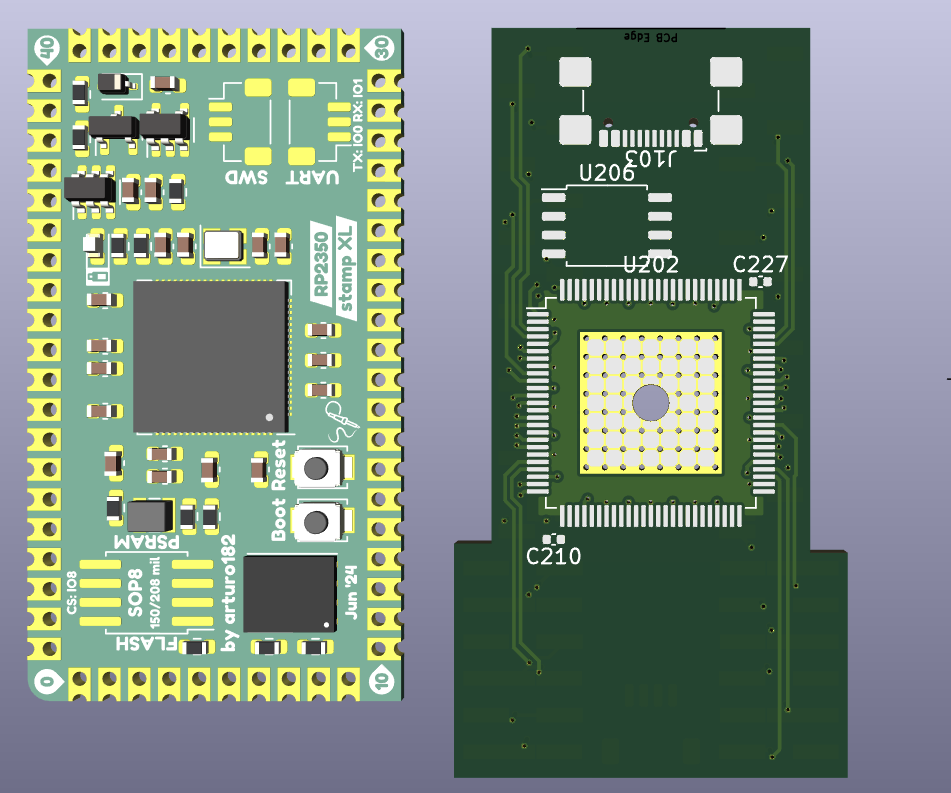

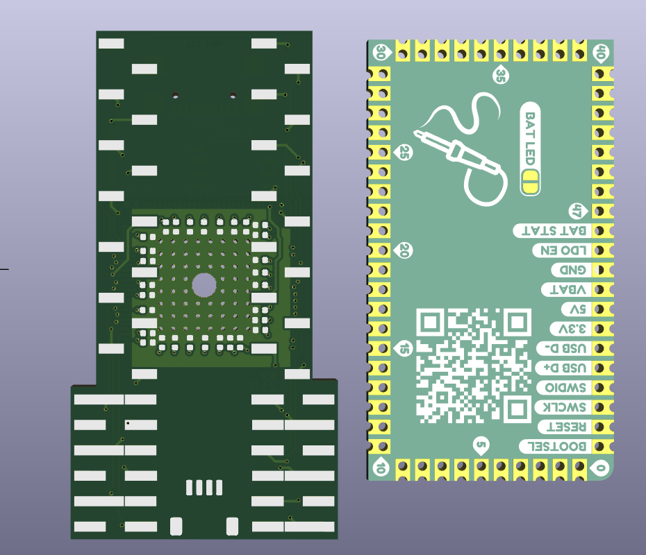

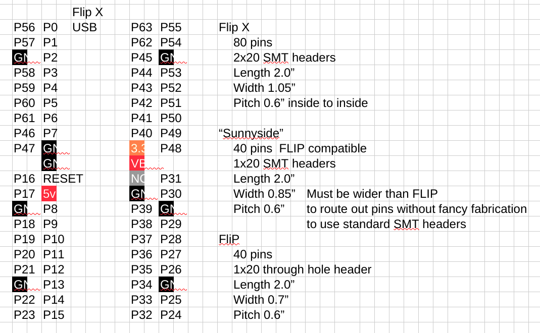

  • I have to ask: Are SMT pin headers problematic? I rarely see them in the wild. I've been designing a P2 module that should fit into most applications using the FLIP. Obviously when I hand solder the prototypes I'll need a fixture to hold the two headers with the right spacing. But could they shift during reflow soldering?
    Maybe this VLA module is not such an expensive idea after all. https://forums.parallax.com/discussion/comment/1566654/#Comment_1566654 Only place I've seen smt headers is these modules: http://janus-rc.com/CF-embedded.html
    The end section is a test to figure out how wide an 80 pin module would be if using SMT headers.
