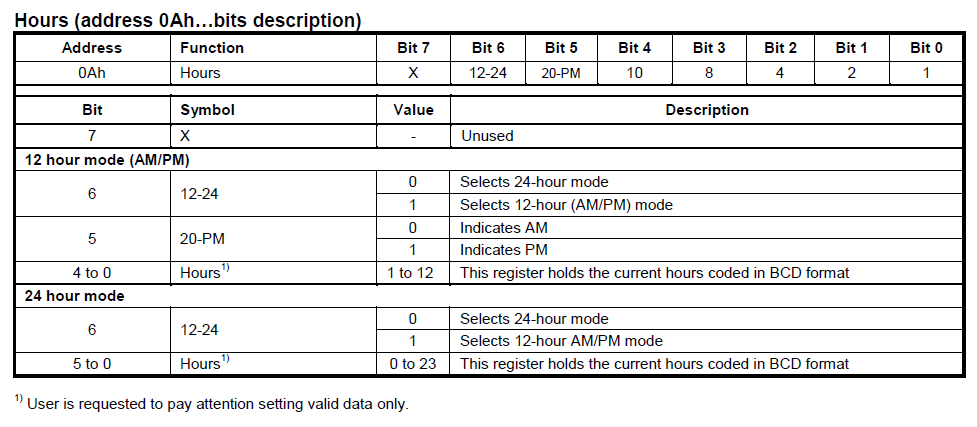

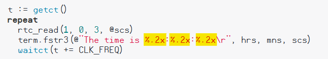

  • So 30 decimal is 0x1E which according to the register info above indicates 24 hour mode at 30 hours which seems invalid. I guess footnote 1 applies and it was set incorrectly to begin with, or at power up it gets set with random data or something like that. Hopefully once you write something valid to it it would then fix the issue.
  • JonnyMacJonnyMac Posts: 9,843
    edited 2025-04-30 15:17
    The RTC registers are BCD so the test code is displaying them as 2-digit hex.
    I think you're correct about writing valid values to the registers to get things going.

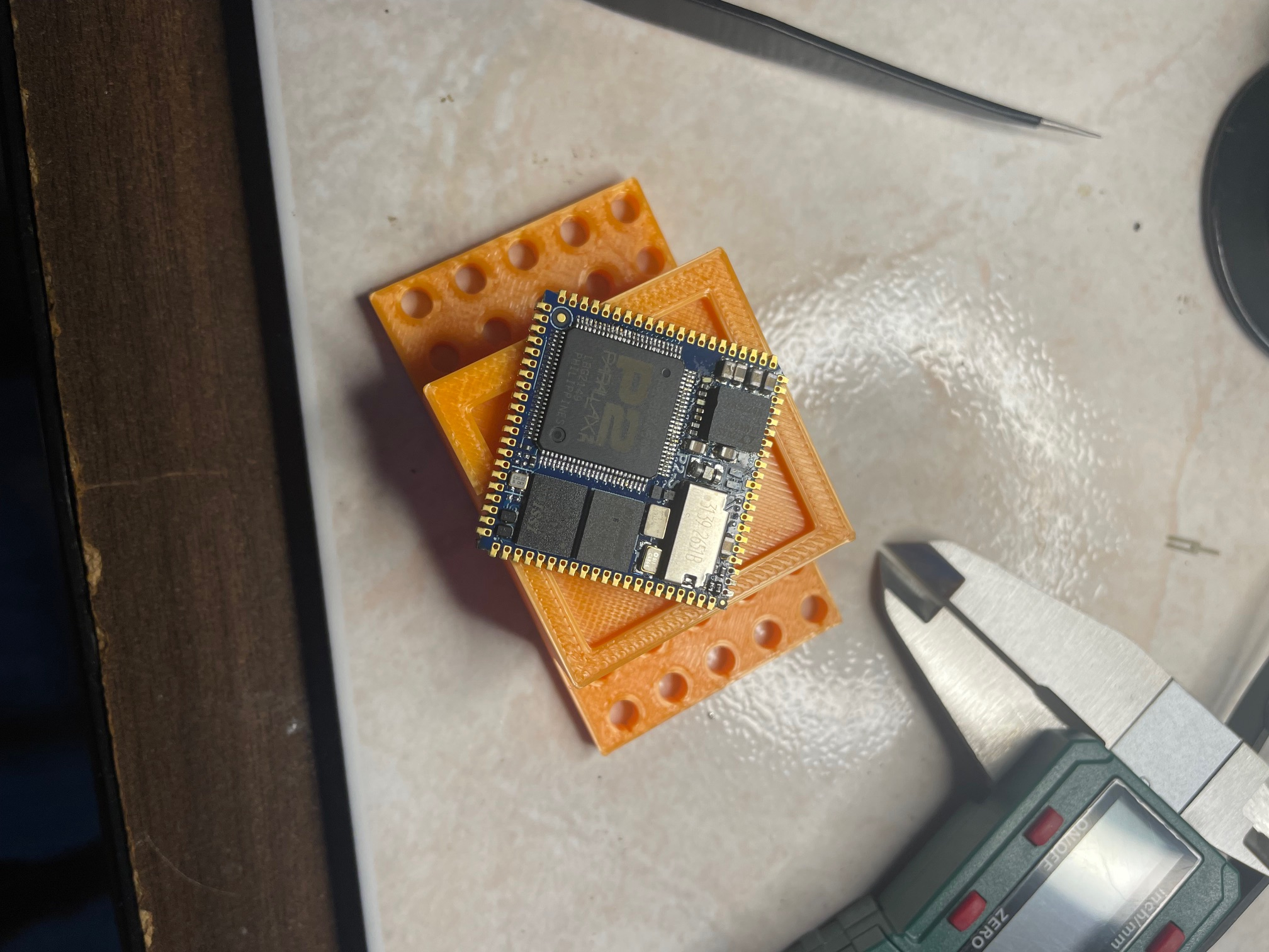

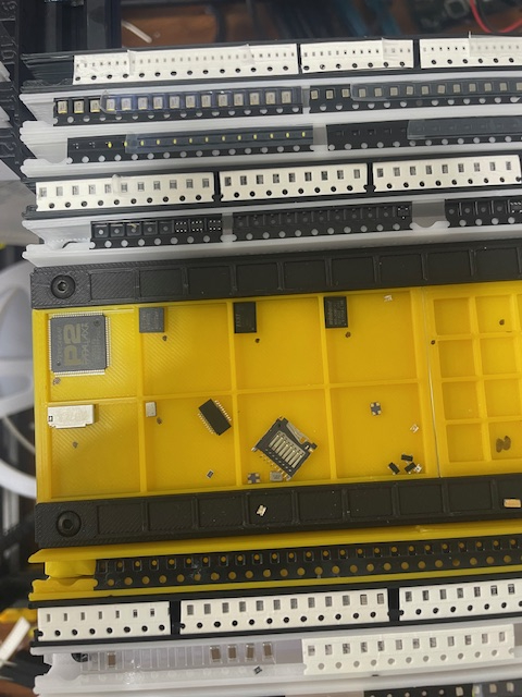

    Got 4 made this weekend. That's a 400X improvement over last week! :)
    Still, not where needs to be...
    Getting some things sorted out along the way though. Should be better next time...
    Need to get the feeders working...

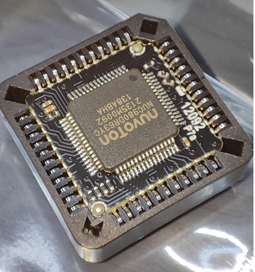

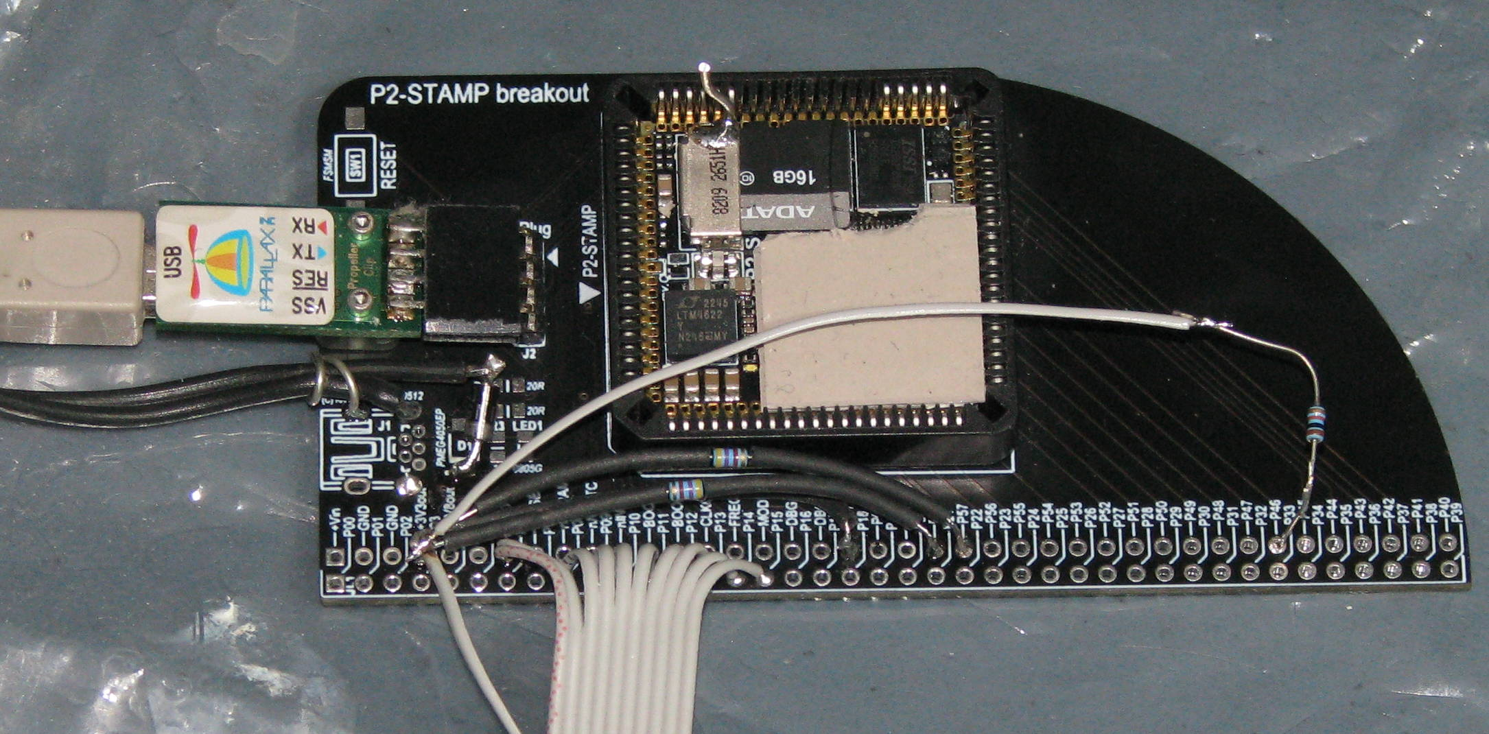

    Was curious as to how secure the P2Stamp was going to be in its PLCC-84 socket...
    Turns out it's a bit too secure. If you push it all the way down, it's very hard to extract.
    Was bending metal on every tool was trying...
    Ordered PLCC extraction tool from Digikey. Seems one needs that if it is pushed all the way down...
  • evanhevanh Posts: 17,312
    You can't have extracted a real PLCC-84 chip in a long time either. Those are even tighter and require a lot more force to extract than the P2Stamp requires. Extraction tools are a must and even the tips of those will bend on some.
  • RaymanRayman Posts: 16,458
    @evanh There seems to be a slight difference between the PCBs that I had made and the original...
    The new ones seem to have a thicker plating on the edges that makes it harder to remove than the original.
    Or, maybe the PCB itself is a hair wider, not 100% sure.
    Just know that the original wasn't so hard to remove when pushed all the way down but the new ones are tighter.
    Actually, wait, I don't have the original. I have some made by Screaming Circuits. These are the ones that are looser than the new ones.
    Guess I don't actually know how tight the originals are...

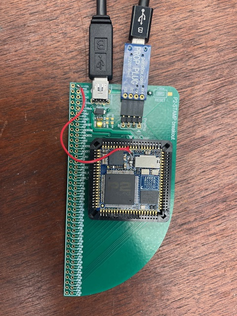

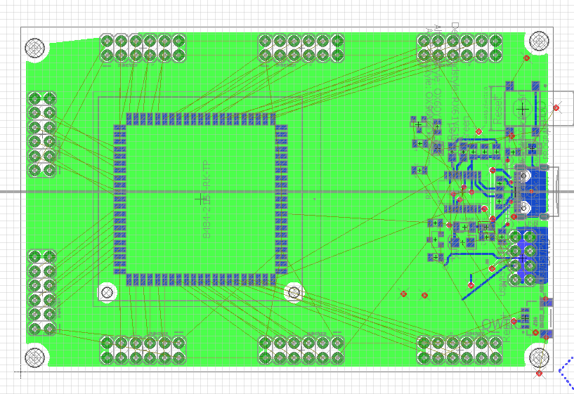

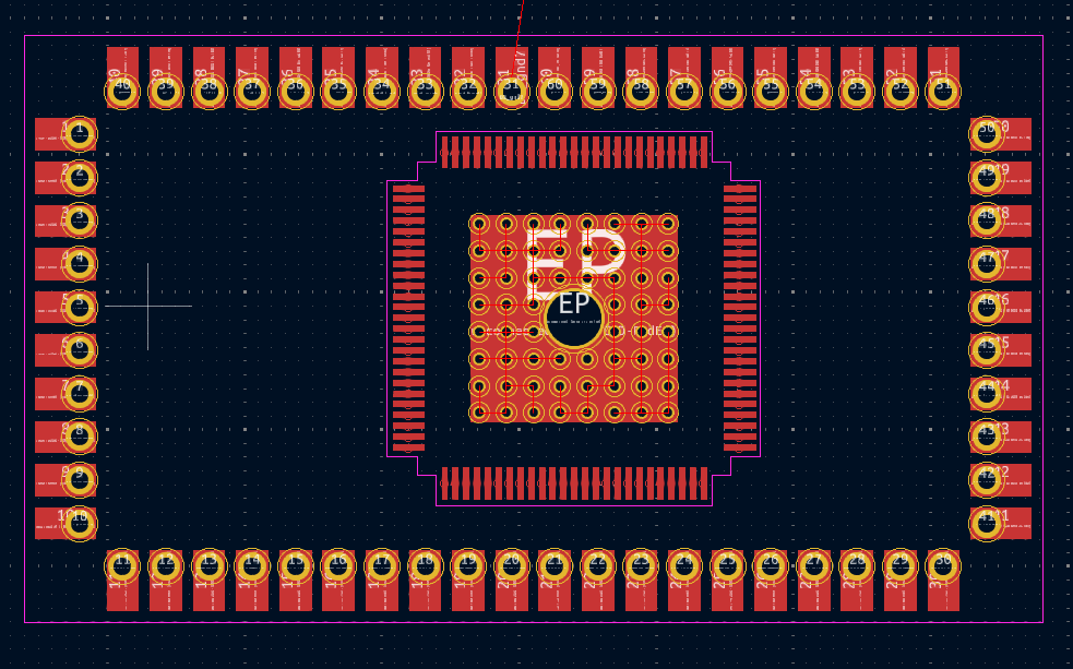

    Here's latest idea for a breakout for P2Stamp...
    817 x 561 - 125K
  • roglohrogloh Posts: 6,413
    edited 2025-05-10 03:49

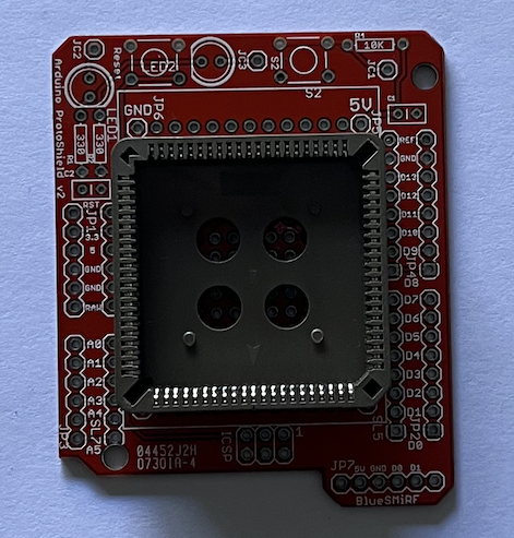

    Also don't discount something using the Arduino form factor. Just checked and a PLCC84 fits in between header pins rather nicely on a shield so you could make a Propeller based Arduino style board pretty easily using this. The larger mega sized board would offer more IO also. 3.3V from/to 5V is the main issue to deal with but there are wide translation chips available - or one can even use series resistors in a pinch.
    edited 2025-05-10 03:58
    Unless the P2Stamp somehow gets cheap to make, it'd be far better to do a Prop2 design specifically as an Arduino form factor.
    edited 2025-05-10 04:06
    True, the cost would be the issue. But convenience is another consideration for some...laying out a P2 board from scratch is non-trivial vs traditional Arduino stuff that beginners often start out with.
    The idea here is really about being able to test all the P2 pins in an easy way and also for something useful and cheap
    Have a few P2 Stamp modules made, but feel like shouldn't sell them without some kind of basic board to house them...
    Or, is there something not seeing?
    Ok, that is kind of interesting. But, think need something for me to make sure every I/O is working...
    edited 2025-05-11 08:17
    @Rayman said:
    Yeah, the Arduino Mega form factor is probably the better bet, has enough IO for all P2 pins to come out.
    Arduino mega form factor is interesting for other reasons. Have to look at that too…

  • jmgjmg Posts: 15,200
    @Rayman said:
    Should also say that @knivd had a plan to make the edge flat, see attached pic.
    He gave me gerbers and tried those with JLC too, but no luck...
    That's still an interesting idea though...
    The socket design would make a true flat edge very difficult, as the plastic fingers are designed to go between the PLCC pins.
    Some scalloping would be needed
    Good extraction will be quite challenge. We've found PLCC socket corners can collapse, as well as IC packages get nibbled into, and that effect is likely worse on FR4 PCB.
    The thru hole PLCC sockets have inner large holes, that could be used with a push-tool, but I've not seen any SMD sockets with those holes.
    You can't remove the inner web, as that provides tension for the pin springs.
    I recall on one project we made a PLCC44 MCU with an araldite-attached handle, that actually worked very well, for initial board testing.
    Would there be room for solder holes in two corners ?
    edited 2025-05-15 10:42
    Holes under the socket to aid in extraction is a great idea! Thanks @jmg
    The smd socket has giant holes as I recall
