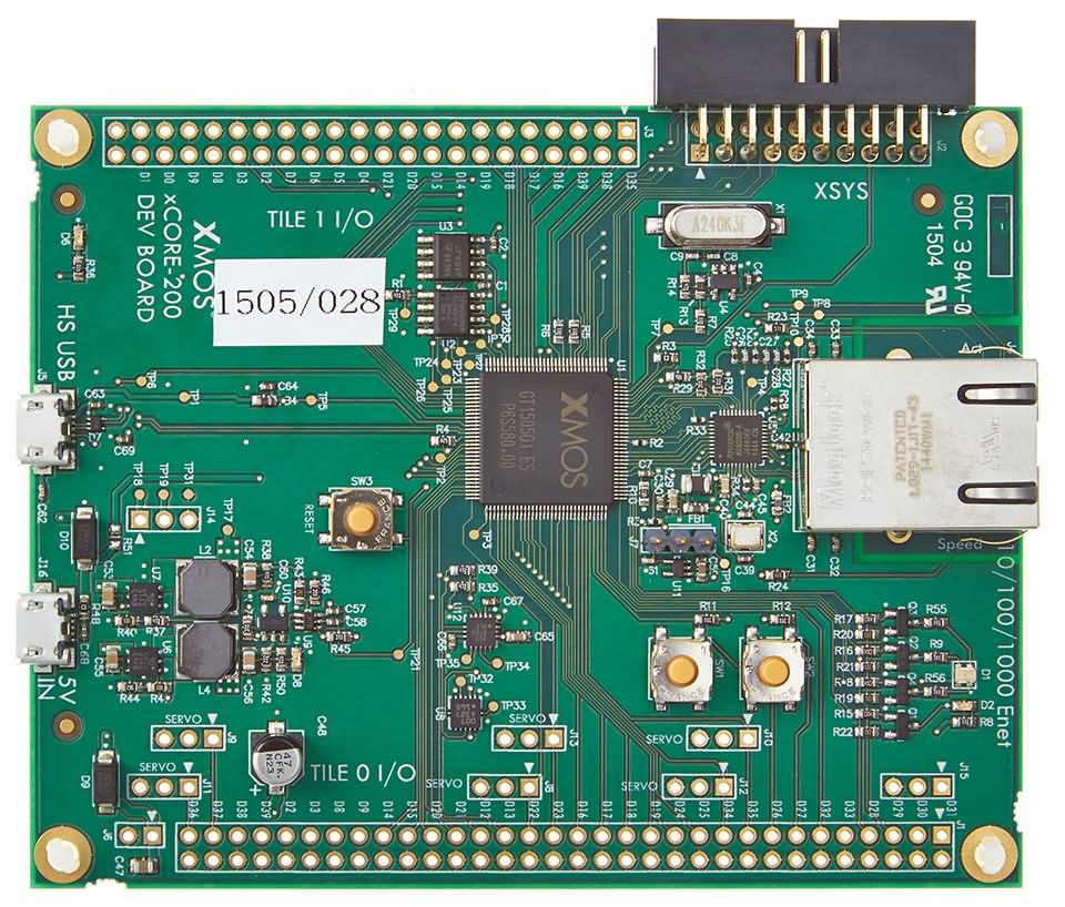

    It's going to find it very difficult competing with the new XMOS xCORE-200 devices:
    http://www.xmos.com/products/silicon/xcore-200
    Up to 32 logical cores and 4000 MIPS. They start at $6.20 for eight cores and 1000 MIPS.
    They have shipped a limited quantity of these eXplorerKIT boards:
    http://www.xmos.com/products/boards#explorerkit-200
    but the devices are not yet in full production.

    Oh, I have to say it again:
    I love XMOS devices it's a brilliant architecture. And I love the XC language, a tweaked version of C that makes it dead easy to setup parallel threads and communicate between them, even on totally different chips! And being a Brit have to wave the flag for them.
    However...I wish XMOS would stop it with that "logical core" nonsense. 32 "logical cores" is actually 4 actual cores (I think they are calling them "tiles" no a days) each of which supports up to 8 instruction by instruction hardware time sliced threads (Similar to what was implemented in the PII in one iteration of the design)
    That 4000MIPS is then 1000MIPS per core/tile or 125MIPS per thread. Mind you if you restrict yourself to 4 threads on a core they will all run at 256MIPS due to the way the four stage pipeline works, if I remember correctly.
    That explorekit is frikken expensive, and not it is only the 2 tile 16 thread device. Confusingly it's hard to tell from the intro blurb what combination of gyro and/or accelerometer and/or magnetometer it has on there. Turns out to be all of them:
    Bosch BMG160 ultra-small, digital 3-axis angular rate sensor.
    Freescale FXOS8700CQ 6-axis sensor, accelerometer and magnetometer.
    Somehow it only has 53 GPIO from one of it's cores, what happened to all the IO on the other core? (N.B. Each core has it's own I/O pins, you cannot use any pin from any core like the Propeller.
    Why are their dev boards so ugly? Green with big, ugly, clunky looking connectors on them. Their original dev boards were small, red and sexy.
    Anyway, my order is going in ...

  • LeonLeon Posts: 7,620
    edited 2015-06-23 02:49
    I can't see any "big, ugly, clunky looking connectors" on them.
    What is that big ugly black thing at the top right of this picture: https://www.xmos.com/files/images/explorerkit-200.jpg
    It's the standard xSYS/xTAG debug connector.

    @Leon,
    Yes, it's the xSYS connector. And it's big and ugly and it's sticking out clumsily at the side there. Blech.
