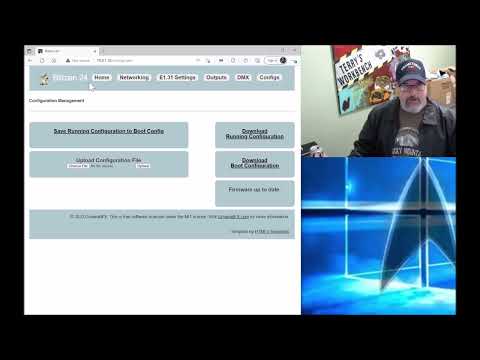

The past few weeks I have completed the E1.31 configuration via web browser:
Additionally, I have adopted a "Running Config" and "Boot Config" type of paradigm for the controller, like you would see with Cisco IOS. This allows you to tweek the settings and can return to what you started with by power cycling. You can also download and upload the configuration via web browser. Configuration is stored on the SD card.

    Here is a video of updating the config on the fly.

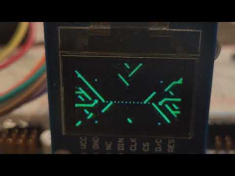

    I am currently adding quad DMX outputs. The last feature is to drive a small SSD1331 display to show the IP address. I will then call it a 1.0 Release.

    It is mid-July and I haven't finished board layout. I need to get that complete. I added the OLED code, so that you will know the IP address of the Blitzen upon boot. It also displays the MAC address, and has icons for E1.31 status and Ethernet status.
    The E1.31 icon is red if no E1.31 packets are received in the past second, green if it has, and yellow if there were any discards. Discards are E1.31 packets where the destination universe is not known to the Blitzen and is discarded.
    The Ethernet icon is red if disconnected, yellow if link is down, and green if both cable is plugged in and link is up.

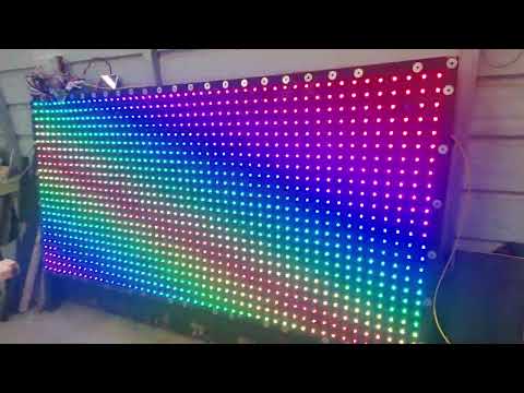

    Complete implementation of Quad DMX output.
    Fix the pixel "glitching" that is visible in the video. Most likely a timing issue related to changing the matching resistor value.
    Complete implementation of pixel timing selection.
    Fix maximum pixels per cog based on maximum pixels per pin group.
    PS: Updated a couple of major bugs in the software last night. https://griswoldfx.visualstudio.com/Blitzen 24

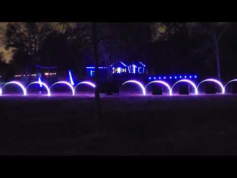

  • I am confident the glitch is not ethernet or pixel data structure related. Adjusting the gamma correction so that the display is dimmer, resolves the issue. This usually means there is a power issue, however power injection along the strand does not resolve the issue. I suspect it is a timing issue with the pixel output. Just gonna circle back to it later.
    In other news, I changed the counters to display good E1.31 packets/sec and dropped E1.31 packets/sec. It displays on both the OLED and the main webpage.
    Here is a video of me testing the pixels I installed on my house using this board.
    That looks really cool, Terry.

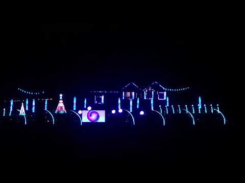

  • PS: Here is the Blitzen 24 that controls the exterior pixels on my house, packaged up in an enclosure with power supply. The picture was taken before I installed the SD card.
  • Better videos. The end of the 2nd video shows the pixel display from the rear. Keep in mind this display is 4 feet tall and 8 feet wide. It draws almost 800 watts (measured) when fully illuminated white at the highest output. Quite frankly, I am unsure why the power supplies didn't shutdown when I tried that. It really lit up the back yard!

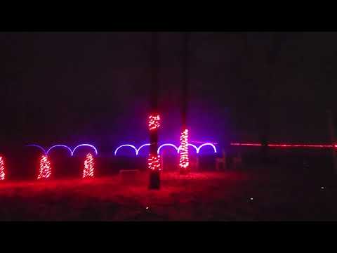

  • Christmas is saved! Yay! I found what was mostly causing my pixel glitch.
    I found that if I just touched the CS line on the Wiznet 6100, glitching would almost all but disappear. I added a .1uf cap on that line, but it caused issues with the browser code and also would not correctly setup the port speed to 10Mbps in the Wiznet. (This was a full hour of head scratching) This made me to look at my code in W6100.writereg(). I found I did not have appropriate delays when any of my code called the writereg() method.
    I am sure there are other bugs related to this as well, but at 1:20AM standing on a step stool, on my front porch holding a laptop with Proptool open, I finally have no glitches on my house, regardless of how "bright" I have the pixels. I have been chasing this for months when I had a moment or two. Running the display glitch free was a beautiful thing!
    In need to make sure that my locks are working correctly and take some real measurements on the write timings. Currently the webserver isn't very happy when the E1.31 receiver if "drinking from the firehose" so to speak. It transmits garbled data. I highly suspect it has everything to do with timings in that routine.
