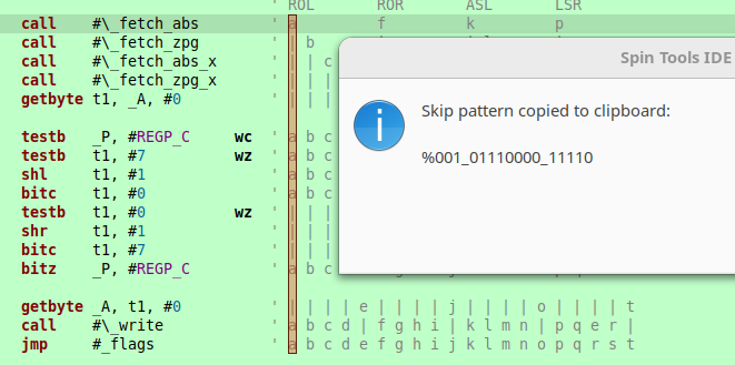

  • Hi Macca,
    I don't know, if this has been discussed before, but here is something like an idea.
    I find, that SKIP and XBYTE is the most unreadable part of PASM. XBYTE can be worse, because the skip-encoding might be on another screen than the code block.
    So what about making this more readable? The actual code could be shown in another window, while a cursor is visible at the same time in the LUT line at the skip-encoding. Each of the lines of the code block could have a check box, if this line shall be executed and the line should be highlightend, if it's box is checked. Unchecked lines just barely visible. The editor could then "re-calculate" the skip-encoding. This would enable to easily insert a line in the code block.
    If another line in the lut table is selected, then the check-boxes shall be updated accordingly.
    Cheers Christof
  • maccamacca Posts: 1,054
    That's a good idea, don't know how difficult would be to allow editing.
    It could start with a specialized hover doc popup window that display the code pointed by the address label with lines grayed-out if skipped, provided the line uses a recognizable pattern.
    If the pattern is something like this:
    Hovering on i_branch or i_log_ind_y could display a popup with the code portion starting from that label with the pattern applied (and I just realized that the pattern I have used in that specific case is not much standard since it uses the last 4 bits as cycle counter...).
    The editor has a small feature to create the skip patterns.
    Enable the block selection with Edit -> Block selection then select the column describing the pattern, then select Edit -> Make skip patter to build the binary pattern and copy to clipboard.
    The column should contains letters to indicate executed lines and pipes to indicate skipped lines.
    Not much but better than nothing...
    Someone (sorry I don't remember who) developed a program to automatically update skip patters in a source, I don't remember the details but maybe it could be a candidate to be used as an external tool, the edited source should be automatically updated after running the program.
