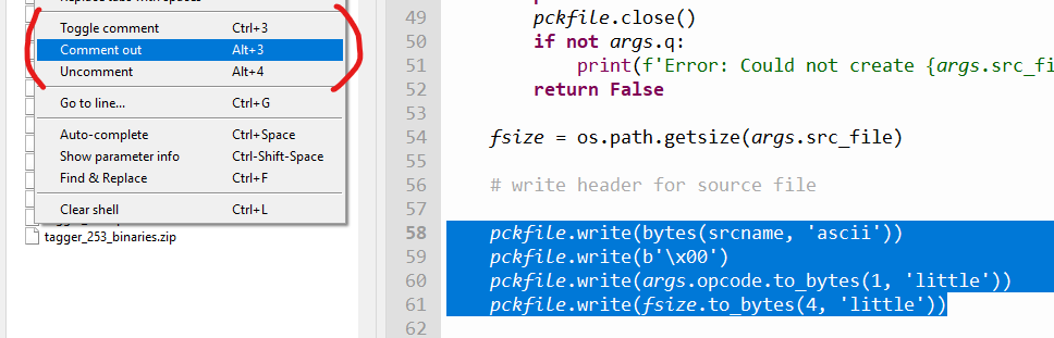

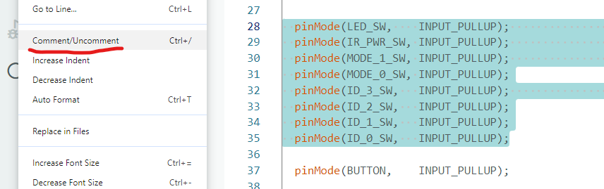

There is a feature in the Thonny and Arduino editors that allow one to selectively comment or uncomment a multi-line selection. This would be very convenient.
Thonny is very flexible with commenting blocks.
The Arduino is less so, but I think this would be enough.
Ideally, the block commenting feature would be available through the Edit menu, or through the right-click menu in the Editor window.
