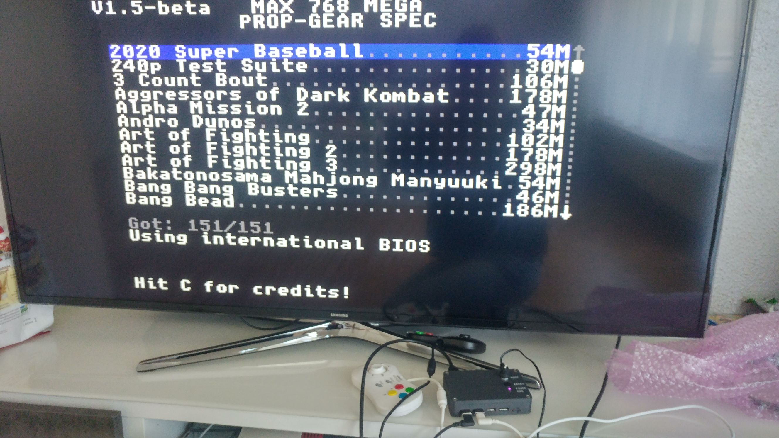

    Just tested your "poc driver" on the "no signal" monitor used before.
    It works ... I also hear the sound.

  • okay @MXX can you try NeoYume with this patched driver (more spec-compliant preamble timing)
    Great, this works like a charm!
    Will try on a few more monitors I have around and let you know

    Update: Despite best efforts by The MatrixTM or other higher powers to stop me by way of multiple cancelled trains and traffic jams, I have managed to travel back up to where the problem TV was and test my fix (of course I came just for that purpose, you know my dedication to the mission)
    It works now. Yay. 🎊
    (I also tested MegaYume, MisoYume, P1CC and Tempest 2000 with the fix applied, all works)
    So that settles the score, it was the preamble length thing.

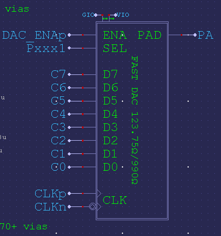

    PS: I'm pretty sure the fast DAC is wired registered always. The function block has a clock input:
