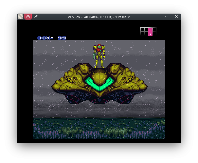

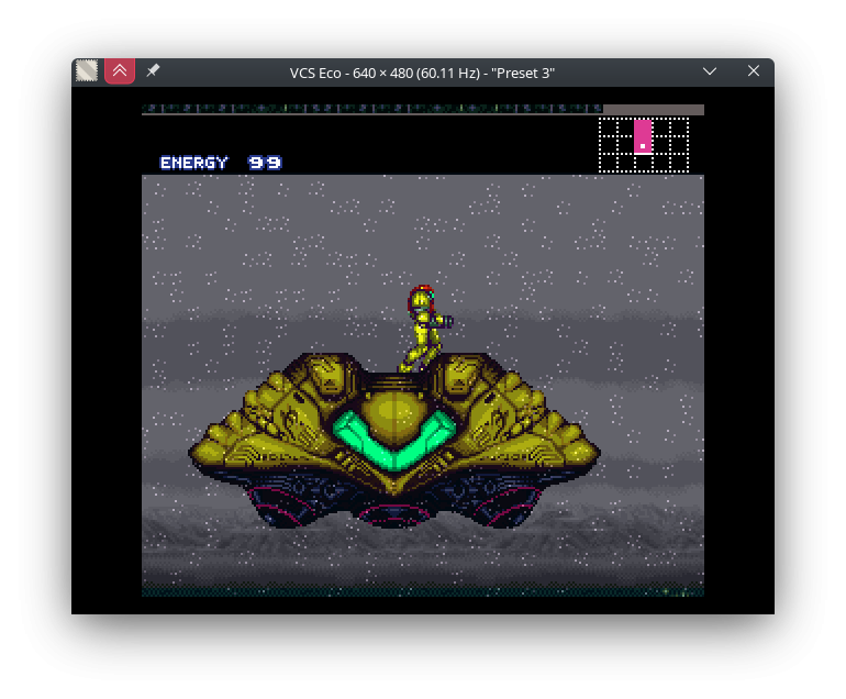

  • With no further ado,
    MisoYume beta11
    As previously mentioned, this release is an optimizations-only one, This means games that previously had graphical glitches due to the CPU cog falling behind (especially on slow 4-bit PSRAM boards) are now FIXED.
    This notably includes:
    • The Legend of Zelda: A Link to the Past
    • Super Metroid
    • Super Mario All-Stars
    • Wolfenstein 3D
    I did not find any regressions, though there's potential for those, as the entire DMA code got re-written and certain A-Bus areas can no longer be DMA source/destination (notably, DMA from/to cartridge RAM is currently not implemented due to lack of test cases).
    I also added some extra info to the file browser.
    Get it at SourceHut, GitHub or grab the attached ZIP file!

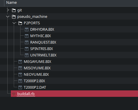

    Yet unrelatedly to any of those things, but to pad out this post with some non-nonsense of general interest, a "sneak preview" of that alleged WIP software I'd mentioned elsewhere :
    (I actually had this on discord days ago, I guess it's go there to get the real (low-effort) scoops?)
    (You can tell it's old because for P1CC it doesn't build @zx81vga games yet, which were finished last)
    The idea is that you just have to write 1 config and then run this script on it and it will grab all the softwares from their git remotes, configure them, build them (including any tools required) and stuff them into a ready-made directory structure (assuming we had a working SD IPL... of course one can also just load the BIX files from there manually).
    Grabbing, configuring and building are mostly working, but I need to find a good way to ingest a machine configuration in a hassle-free manner (i.e. where you can say "A/V accessory on basepin 8" and it automatically figures out the analog audio and video pins) and convert that into project-specific config values. Also PSRAM latency settings are ??? (will definitely need a way both to guess the correct setting and to override that when it goes badly). Also need a way to reject building stuff that can't possibly be configured (e.g. can't configure NeoYume on a PSRAM-less machine no matter how hard you try).
    Also need to figure out how to best get the prerequisites and turn that into a guide for Linux/Win/Mac/etc (currently: ruby, git, bison and gcc/build-essentials).

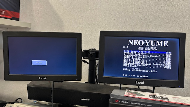

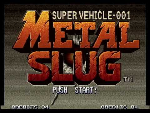

    Okay, something very interesting just happened.
    So, I went to stay at someone else's place last week. I decided to bring the @MXX Thing with me for entertainment, allocating valueable backpack space to it. I built all the emulators with HDMI support and then flashed them to the board.
    When I arrived I found that neither of 2 TVs available would accept the signal. One was some crappy new-age thing where everything was really slow, the other was a Samsung very similar to the one I have here at home. (same remote and OS / menu structure)
    After some mucking about I found out the following:
    • Roger's text driver works. (at least with the settings I have in the usbnew samples)
    • My VNG driver (NeoVGA etc) works in DVI mode, but NOT in HDMI mode. The TV totally rejects the signal, no "invalid mode" or video-but-no-audio stuff.
    • My HDMI scan2x proof-of-concept driver (that plays OPN2Cog audio + static picture) also works (incl. audio).
    • Trying different cables or pin drive modes made no particular difference
    Considering two TVs failed, one apparently being extremely similar to the one I have at home, I mentally filed this as a code regression introduced because I only ever test with the ASUS monitor and the VisionRGB card, which both take aaaanything you throw at them. I had Better ThingsTM to do than to thoroughly live-debug this stuff on the scene with my thinkpad and thought I'd be just able to reproduce this at home.
    Turns, out, no. It just works on the Samsung TV I have here. So I'm at a loss now as to what would cause this and unable to repro it without spending a day riding stinky trains up north (and bothering my poor hosts by futzing around with their TV).
    Possible ideas in order of decreasing likelihood:
    • Something wrong with the preamble or guard band signalling that these newer(?) TVs don't like
    • Something wrong with the AVI InfoFrame and these TVs are more picky
    • Something wrong with the audio packets (unlikely, that usually just kills the audio and leaves the video alone)
    • Divine intervention, higher forces really wanted us to watch TV shows instead (honestly can't rule it out at this point)
    So the best thing I can do now is ask if any of y'all on here can test NeoYume on a bunch of different TVs and similar devices. I know I went on a whole bit with @rogloh on debugging it previously on his Pioneer Plasma (can you re-check that still works? I'm going mad out here and need some assurance), so I think I can remote debug these things. Just need someone with a similar repro case (MODE_DVI works but MODE_HDMI does not). (also try the usbnew sample programs with roger's driver, they're less of a hassle to set up)
  • evanhevanh Posts: 17,305
    edited 2025-10-16 14:58
    I found that blanking can easily become too small for some displays. Minimum Hblank of 80 and minimum Vblank of 20 did well on many DVI and HDMI.
    EDIT: I guess that's always DVI mode. What is HDMI mode? I didn't know there was a difference.
  • Wuerfel_21Wuerfel_21 Posts: 5,862
    edited 2025-10-16 15:17
    HDMI mode is HDMI signalling. This allows "data islands" to be sent during blanking (audio packets live here! and that's the main reason to use it over DVI) but the video signalling also changes slightly (presumably to help the sink lock on easier?)
    HBlank is plenty large because it needs to fit that whole [data preamble -> data guard -> 2x data packet (audio data + audio clock) -> data guard -> video preamble -> video guard] sequence. I was also using the 640x480 mode, which has really wide blanking to accomodate the high clock speed. Maybe I should re-check this, but all the preambles ought to be sufficiently long (as per HDMI spec). VBlank is NTSC quasi-standard stuff (so plently lines).
    EDIT: oh yeah btw HDMI and DVI modes are almost the same in my code, the only thing that really changes is the function pointers that handle sync and blank lines. So the timing should be the same between them. HDMI also enables the audio processing overlay to run during active video, but I don't think it's that, it wouldn't work anywhere at all or introduce visible glitches if that was causing e.g. timing issues.

  • roglohrogloh Posts: 6,412
    edited 2025-10-17 00:58
    @Wuerfel_21 Once I get a chance this weekend I'll try it out again on the Pioneer plasma to see if you have a regression. My problem was a combination of multiple effects that also included lack of 5V presence when tested with audio output - all had to work to have audio work.
    I wonder if these TVs were somehow being far pickier in their supported resolutions? Did you try out anything really generic like true VGA over HDMI at 25.175 MHz with 800 total pixels / line or 576p/480p etc using standard N/CTS values and without any custom/non-standard timings using shorter blanking intervals etc? i.e Modes associated with VIC values in the various CEA-861 docs.
    I also wonder if it could be somehow confused with the Infoframes being sent or their frequency? I vaguely recall there were some minimum settings there - but hopefully your code is already following that.

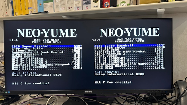

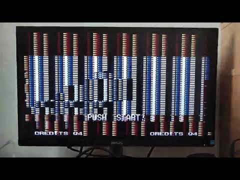

  • MXXMXX Posts: 25
    edited 2025-10-17 11:05
    I tried NeoYume MODE_HDMI on two different monitors.
    One worked (video+audio) while the other is not working (no signal message).
    As expected, using MODE_DVI, works on both monitors.
    Nice to see that HDMI works together with VGA using MODE_HDMI_VGA. On VGA the image is a little stretched.
    (MODE_DVI_VGA: same monitor DVI on the left, VGA on the right. MODE_DVI also working)
    (MODE_HDMI_VGA: same monitor HDMI on the left, VGA on the right. MODE_HDMI also not working)
    (MODE_HDMI: on a brand new, huge, ultrawide philips monitor. It works with audio. The image is doubled by a "special" mode of the monitor itself, but it's the same hdmi signal on both sides. Also MODE_HDMI_VGA is ok)
    edited 2025-10-17 11:36
    Okay huge thank you @MXX.
    Do these monitors that don't work have speakers in the first place? (They in theory should still accept the HDMI-encoded signal, anyways, all the ones I've seen do, but there's a valid chance of being plain DVI devices that just don't like the extended signalling, full-stop)
    Also, here is the aforementioned PoC driver (compile opn2test_top.spin2, should already have the right pins) to try out. This one didn't have the no signal issue for me, but beware that the audio handling on this is missing some bugfixes the VNG driver did get (as discussed above) so it's ok if it's just picture and no sound.
    BTW: The simultaneous VGA output being stretched is just how it has to be. If you try a game from P1 Classics Collection, you'll notice that those all have a non-stretched VGA output because they use a more relaxed timing. (Note: I didn't have any of these flashed last week and didn't bother testing it, woe is me)
