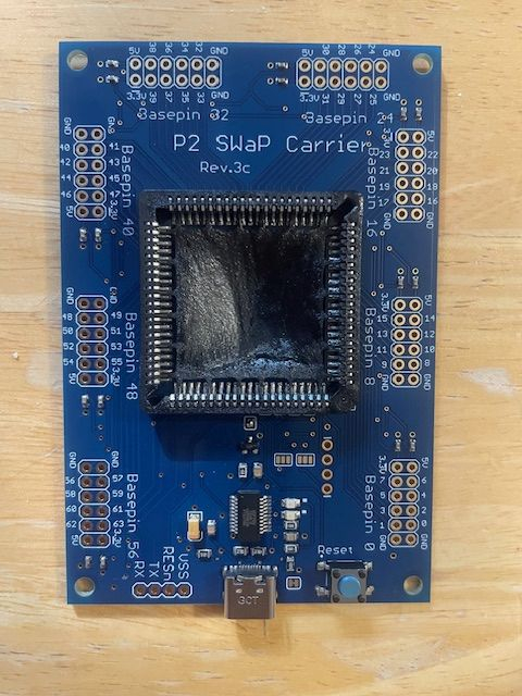

Having second thoughts about the smt version of PLCC-84...
Middle melted into the cutout under the socket...
Or, maybe shouldn't have the cutout...
Think the socket shrunk a bit because module was very difficult to push in.
Idea for the cutout was so could solder SWaP module directly to the PCB. But, that doesn't work either because the pads don't stick out far enough...
Also, the pinned kind of socket has four holes that suppose can be used for pushing out the module, if there were a cutout underneath.
Have to remember that, if switch...
Other thing is that you can't really get to the pins in case any two are shorted together by solder.
Maybe this is unlikely though...
Just check with an unbaked SMT PLCC-84 socket and that is also tough to push the module into.
Guess melting didn't affect that, just the way it is.
Might be a good thing...
wow, that's not liked that at all.
It's likely to be unreliable, as the fingers underneath help transfer the force of the centre pins, which try to bow each of the sides.

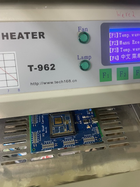

What type of oven did you use to solder it? If it's an infrared heater (converted pizza oven) the problem might be that the heat source is much hotter than the desired peak temperature of the PCB. Black materials absorb more radiation than the silver metal surface of the solder and the green surface of the PCB. The middle area of the socket has no direct contact to the PCB but a thin layer of air in between which prevents heat exchange. So the socket gets much hotter than the solder joints.
Convection ovens are better, vapor phase ovens are much better. The evaporization and condensing of the heating fluid equalizes the temperature on all surfaces perfectly.
Oh wow that looks unhappy. This is where the datasheet ought to be consulted as to the max. rated soldering temperature.
It's just the giant cut out underneath... Makes it twice as hot... Have to find something to fill that cutout during reflow...

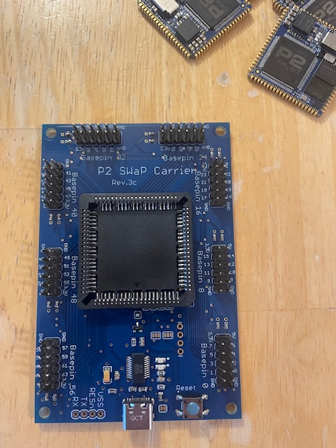

Found a solution... Put a blank PCB under and a blank SWaP PCB on top. Seems to work.
It's still very tight though... Need tool to remove the module for sure.
