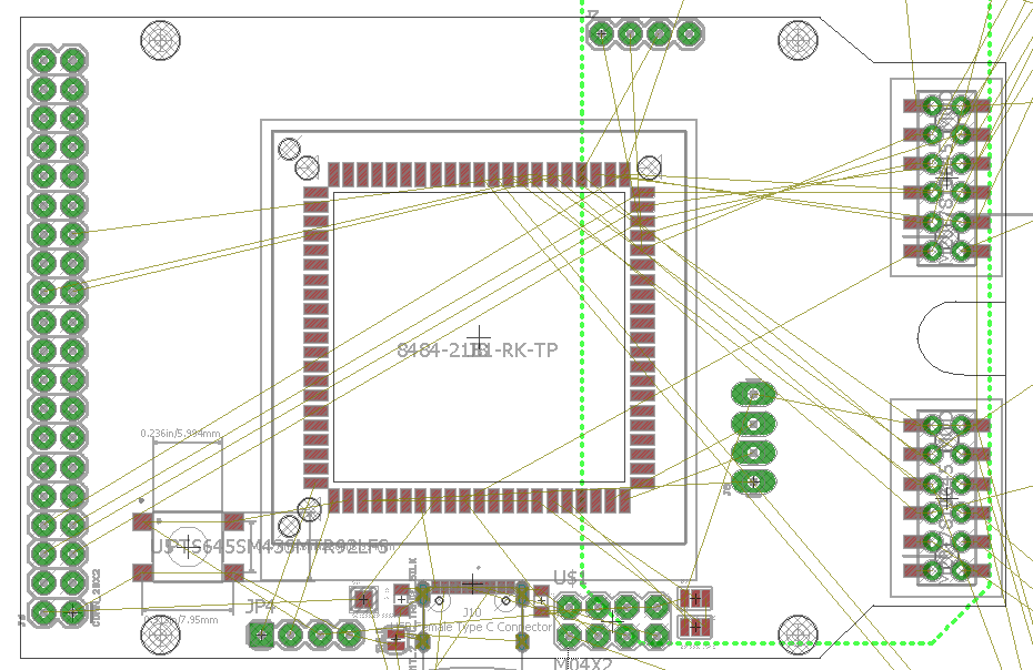

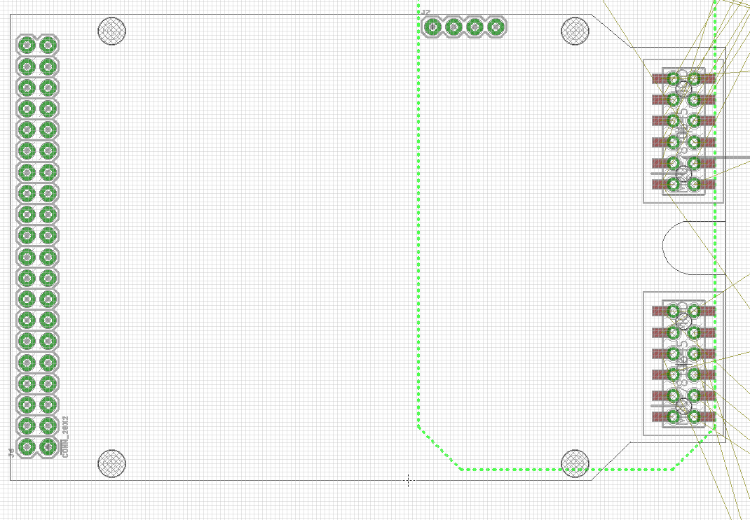

    Toying with this idea that might take out 3 or 4 birds with one stone...
    Can add extra P2 to a P2 with at least an 8 bit bus between them.
    Can daisy chain multiple displays using ffc and 40-pin connectors...
    Can be a stand alone P2 board
    The square hole in the middle might make 2 layer wiring tough...
    930 x 604 - 95K
  • evanhevanh Posts: 17,308
    edited 2025-05-19 00:58
    That needs to get 1.8 Volts from somewhere. I wouldn't want to pull from the two 3.3 Volt regulated pins. That still leaves three options:
    • Use the two 5 Volt pins. They're typically directly from a heavier supply. And given very few add-on boards even connect them at all there's a possible option to further boost voltage. 12 Volts maybe.
    • The 40 pin header may have a supply from it, but I suspect not.
    • Have a dedicated supply connector. Most robust option but also most inconvenient.
    PS: If attempting raised supply voltages then it becomes important to get into the habit, if you haven't already, of powering everything down before plugging and unplugging add-on boards.
  • RaymanRayman Posts: 16,457
    edited 2025-05-19 09:53
    @evanh Thats the P2 SWaP module there….
    Either powered by USB-C connector, 5v from connected P2, or lipo

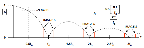

    Wondering if several P2 pins could be tied together in order to drive a speaker...
    But, maybe console output is digital and counts on amp to cut off high freq?
    I had some code at some point to use 2 pins to drive symmetric audio (so double the peak-2-peak voltage), but I don't think that ever made it to the emulator code bases, I think I only had a hacked version of OPNAcog with that.
    Some of the emulators have built-in low-pass filtering because the raw signal sounds too harsh.
    Another thing to note is that the P2 DACs are zero-order hold (stairstep-like signal), so frequencies close to the nyquist limit are attenuated slightly and high-frequency images are present:
    Small speakers usually have poor frequency response, so an amplifier circuit tuned to make up for it (i.e. if speaker is weak at low frequencies, boost those) can increase quality a lot.

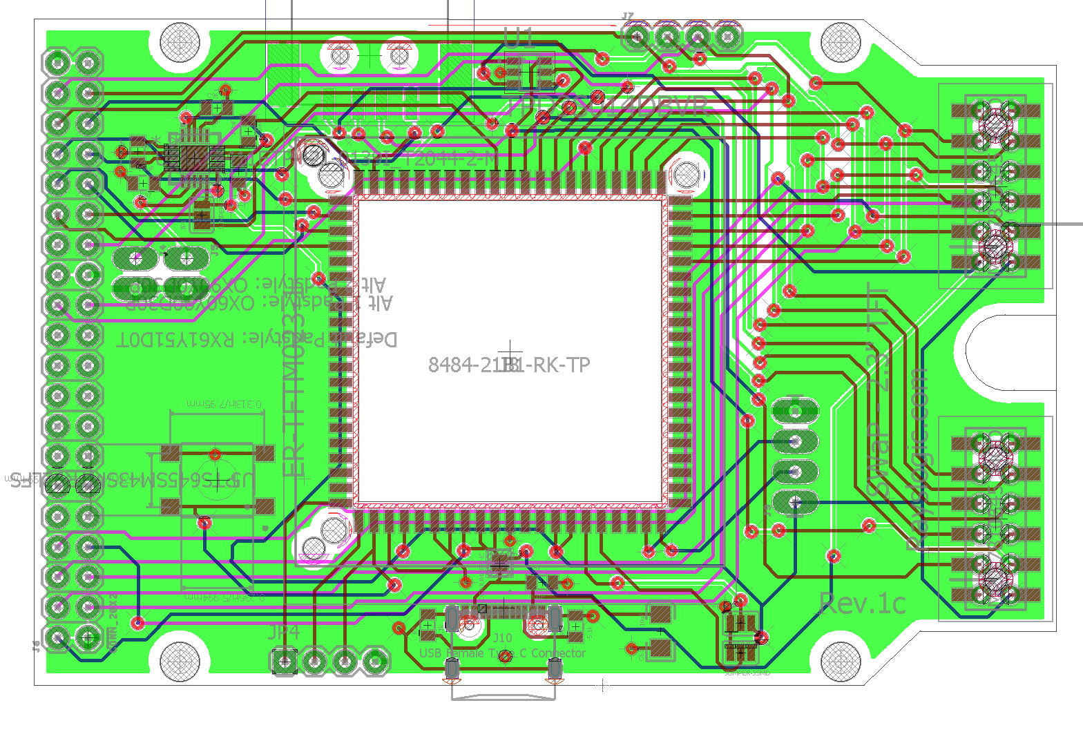

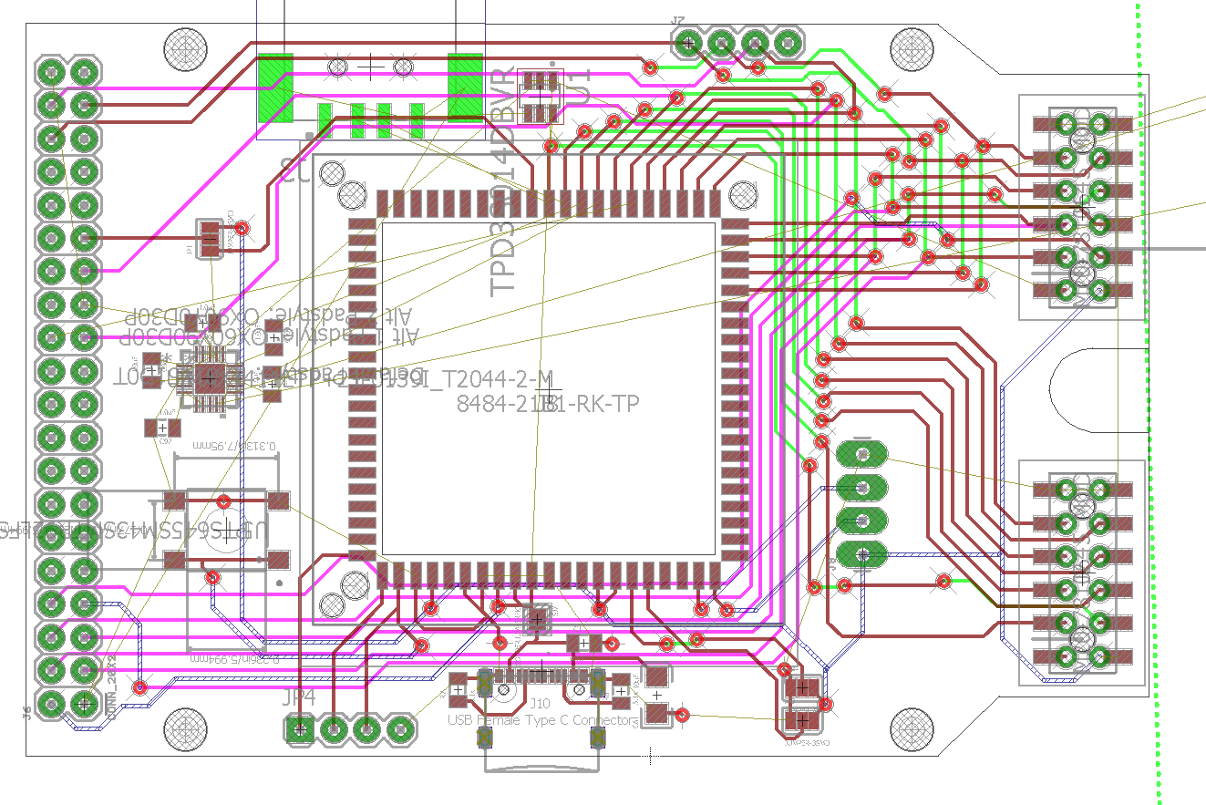

    Wiring for this board is very inconvenient... Had to switch to 4 layers...
    Think it's close now though...
    1323 x 883 - 187K
    You could make the board wider still. That would allow more routing space alongside the Prop2.
    @evanh Maybe. Want to make a compact module though...
    Think this is ready to go now. Be nice if it actually works...
    1568 x 1060 - 313K
