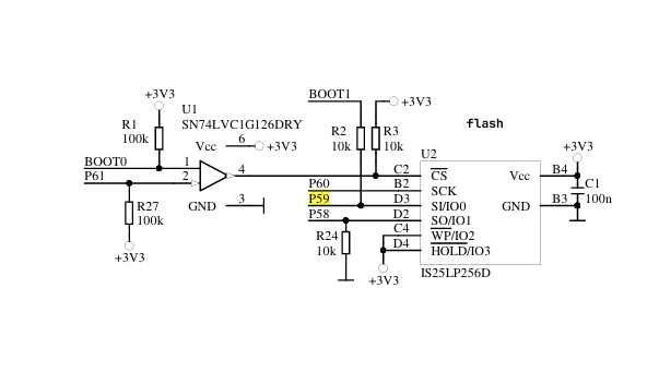

    Started testing with uSD and seeing something strange...
    Seems FlexProp can load with uSD inserted, but Prop Tool cannot.
    Have to figure this one out, very strange...
  • RaymanRayman Posts: 15,886
    edited 2025-05-26 22:23
    Hmm... Works with SpinTools IDE with uSD installed.
    Maybe messed up Prop Tool somehow...
    Hmm. Doesn't work with PNut with uSD installed either...
    Guess it's in same boat as Prop Tool...

    First guess here is that it could be reset timing pulse differences in the loader SW along with pullup/downs seen on P61,P60,P59. Maybe P59 is being pulled down and/or locking out the serial window? If you pull up P59 weakly does the problem disappear?
  • evanhevanh Posts: 16,975
    If the SD boot option isn't disabled (Disable with a pull-up on P59) then a bootable SD card has only a 100 ms timing window for serial to get control first. It's not surprising that downloader programs haven't been well tuned to catch this correctly. Both Eric and Macca have belatedly put extra effort into getting it right in their respective downloaders.

    This is with the core build where I left off a bunch of parts. Maybe I left something I shouldn’t have….
    Not seeing pullup on P59 anywhere... Guess that's something user needs to add...
    Yeah, pullup on P59 lets it work with PropTool when uSD is inserted. Wish new about this earlier, but oh well...
    Something must be pulling P59 high in full build, but don't know what.
    Don't see any change in the P59 voltage when uSD is present or not, very strange...
    Seems the Boot1 option resistor (R2) has been left off in the "core" build. Could fix that and force serial only boot, but not liking that...
    Thinking that maybe the "core" build should include the flash chip.
    Maybe that would fix whatever is going on here...
    603 x 341 - 26K
    Or Chip sorts out Parallax's downloader so it can intervene in that 100 ms pre-boot window when a bootable SD card is present.
