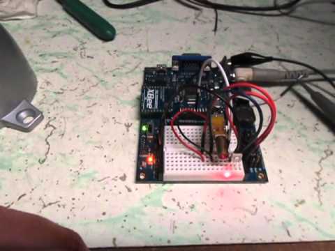

    Just got my two EG laser modules today to test.
    http://www.goldmine-elec-products.com/prodinfo.asp?number=G19601
    I can say they run fine at 5 volts with the Hamamatsu receiver.
    Looks like it has a 91 ohm resistor built on. Cool!
    Will let it run over night to see if any smoke lets out.

    Thanks for the feedback, Jim. That's great news, since I ordered 75 of them! Only two for you, Boss? :)

    Still working well after two hours.
    Even though the the EG site specs it 3 volt, it is 5 volt tolerant.
    Smaller dot than laser pointers.
    edited 2014-01-16 13:33
    Steady on, or with the sensor? Range still 8-10 feet?

    Connected to sensor, (modulated). 15' with:

    Don't leave me hanging, Jim! 15 feet with ...?
    edited 2014-01-16 14:11
    standard circuit and reflective that I linked to.
    edited 2014-01-16 14:33
    15 feet is great! You're makin' this old dog proud, big Jim. :)

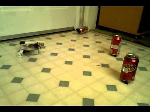

    Yesterday I made some targets out of my 3M tape, one inch dowels, and a wooden base. I then had my robot scan for the them at different distances. I found that the detection range is noticeably shorter when the robot is moving relative to the target. I imagine that there is a required time at a specific intensity to trigger the sensor.
    The 3M tape kinda stinks and I need to buy better tape. But I imagine that increasing the diameter of the target would make the surface slightly flatter and increase the amount of time for the reflection to reach the sensor. Philo used a 40 mm target while my dowels are only 25 mm.
    edited 2014-02-03 08:28
    Since 25mm<1" , I guess you meant a 1" dowel. :)
    Yes, I notice on my ~3" dia soda cans that it's still mainly the center, more "perpendicular to the laser" area that gets sensed. The quality of the retroreflective tape definitely makes a difference.
    Good to hear you're experimenting with these sensors. I want to see what you & others come up with.
    edited 2014-02-03 18:36
    I tried a moving robot with a Campbell's soup can with some 3M tape, and it had a two foot detection distance. The wooden dowel had an eight inch detection distance, so it looks like diameter makes a big difference. This makes sense because the larger the diameter the longer the reflection will hit the detector.

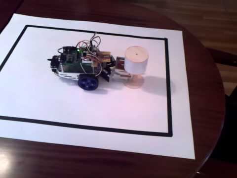

    This took much longer to get done than I expected. The basics were pretty simple, but coupling all the behaviors together was a fair amount of debugging.

    Nicely done Martin!
    Are you still using the 3M tekk 03440 tape? I could not get it to work consistently on a round surface also.
    I am stalled on my project trying to source a cheap plastic lens that I can drill a hole to fit the laser into. Dollar store has tuned up nothing.
    McMaster may be another place to shop.
    Jim
    edited 2014-03-30 16:53
    Thanks! I'm still using the 3M tape which is not good. I think mylar or that tape from eBay would be better, but I wanted to just get something working with what I had on hand. All the concepts and code will work if I have better tape and a bigger ring.
    I'm not using a lens for the laser as my module has a built-in lens that works fine. I just keep the laser and sensor close together and it seems to work.

    Erco, I haven't used a different laser because I'm certain the problem is the 3M tape. With a mirror I get a fifteen foot range, easy peasy, so I just need better reflector tape. This was still a fun project even with the bad reflector tape. Plus the Boe-bot running around with a laser on it is cool.
    I could see many uses for the laser and targets. Cat and mouse robots, or navigation markers all seem possible.
