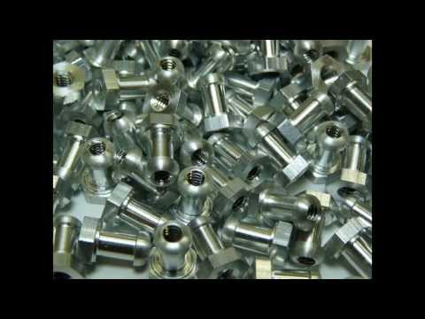

    I just received three* standoffs in the mail today. They are so small! I will use them on the HoverFly Pro board.
    Thanks Tiger/Julia and Ken!

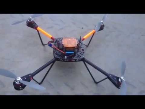

    Well, I got to the mounting of the Hoverfly Pro and GPS and found that I'm not going to be able to use the great little standoffs. I will send them back to Ken unless someone wants to give me an address so I can snail mail them to you directly.
    I wound up using the hoverfly "hardware" (actually nylon screws) along with their grommets. I had to do some minor modification to the mounting system in order to accomodate the larger board. I also have to put some kind of cover over the whole thing to protect the boards, but more importantly, to mount the GPS antenna at least 10cm away from the electronics. When I get everything figured out I'll take some pictures. Still working out the details.
    I also found a nifty little RC tx/rx controlled switch to turn the LED lights on the booms on and off in flight.

    dmagnus - Just wondering what the issue is with your setup and the standoffs. I just went to the HoverFly site to look at the Pro and I don't see a problem. Does this have something to do with needing to stack the boards? If so, I think there may be an easy solution.

    As you can see (I hope this stuff comes through) from the pictures below, the Pro and GPS boards are approximately 25% larger than the Sport board. They also use larger mounting hardward (nylon screws and nuts) and larger grommets. It looks like the grommet holes are the same size in all of the boards, but the larger (6-32? 8-32?) screws fit perfectly. I drilled out the outer holes on the mounting board from Parallax to accomodate the larger hardware and mounted the mounting board to the top frame of the ELEV-8 with the 4-40 screws and standoffs in the inner holes. It looks like everything will work, but if anybody sees anything that I've really screwed up, please holler...
    I'm going to use a power filter and fabricate some kind of canopy for the boards from a food container as recommended by Hoverfly. The canopy will also allow me to mount the GPS antenna the required 10cm from the electronics.

    I am using all of the parts that Hoverfly includes with their boards. In the Pro, you basically get the grommets. With the GPS board you get more grommets, standoffs for between the boards and nylon screws and nuts. On the "in the box" page (pp 18) of the
    GPS manual, the following note is displayed prominently:
    Important:The included Nylon Standoffs should be used to space the
    HoverflyPRO and HoverflyGPS properly.
    The boards will seat closer together, but they must have a reason for spacing them as they do. The top part of the pins are silver in color while the bottom part that seats in the Pro board are gold. When seated with the standoffs, only the silver shows.
    I've included some more pictures that show the contents of the package(s) and the boards mated as shown on page 21 of the GPS manual.
    When the boards are joined as shown and the whole assembly is screwed to the ELEV-8 base plate (made for the Sport board and modified as shown in my other pictures, it appears that everything is very secure. The boards are held by the grommets and the screws go through the holes in the grommets perfectly (not too tight or loose) so I think it will work fine.
    I don't know how the Sport board was packaged, but if you only have grommets and use 4-40 hardware, I could see how you might have problems.the
    Are you worried about the use of nylon hardware?
    Oops, forgot the measurements. With the included standoffs the space between the boards is .480, the standoffs are .315. If you mash the boards together to fully mate the pins (beyond where they have them marked) (see third picture for the pins) the distance between the boards would be .390 plus the shoulder of the grommets. The distance between the grommet shoulders is about .230.

    dmagnus - Thanks for the great photos and the measurements. Using the Hoverfly hardware that fits the grommets is better than the ELEV-8 4-40 screws, but its still not the best solution. The basic problem is that the grommets were designed to dampen loads up to three pounds and we're trying to use them on something that's not even three ounces. I think it's still worth taking a look at different configurations that might help. BTW - That line of silver/gold is just the result of selective plating of the gold. It has no significance other than that. It's just a way to save money by not plating non-contact areas with ($$$) gold. I wish they had that selective plating on all their connectors. It would certainly help reliability.
