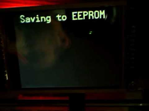

    Hi guys !
    See this video showing my last developement for the PropPad ! :
    [noparse][[/noparse]

    I have seen the video....very very nice...what have you used finally for the touch screen driver?
  • Reset_VectorReset_Vector Posts: 55
    edited 2010-03-09 14:51
    Hi Nicola and the others propeller addict's
    I've used the ADS7843 controller, very easy to use, but little package (SSOP16), uses I2CObjects.spin;
    The hardest part to do was the calibration process, see : http://www.embedded.com/story/OEG20020529S0046 for more information, but as I'm not mathematical, I've searched on Google.
    After few "Googlades ?!" I've found an example in C for the arduino, I translate in SPIN, and after a some hours, it works ! Pfuh !!! , the big part is made.
    I'm now about make the driver clear and clean.
    I'll post both ST7781 (LCD controller) and ADS7843 (touch controller) drivers as I "ll make an demo package .
    Best regards from France.
    edited 2010-03-15 10:45
    Hi,
    Today I've build another PropPad board and when I test it, the LCD don't work.
    The propeller comm's are all ok.
    I've tested the connections between the LCD and the propeller and all is OK.
    I though there was an hardware problem, as I have the same problem with the first PropPad i've made, on wich I have changed the LCD and after all works fine.
    I though there is an problem during the initialization sequence :
    When the prop starts, all the I/O are configured as Inputs, so there are floating, no ?
    At this time, the CS line of the LCD could go in a state where the CS line is valid (low), and the LCD takes the state of its inputs as data and goes in an unknow state.
    I've soldered an 100K resistor between P2.7 (CS) and VDD.
    Miracle ! It works at each time I powered the PropPad or at each time I reset the board via th F7 on the propeller tool !
    @Jazzed, could you test this workaround ?
    I know your board never works.
    Leave feedback if this issue works, Tripp have to modify his board routing and the others owners of the PropPad could modify them....
    Sincerly .
  • MagIO2MagIO2 Posts: 2,243
    edited 2010-03-15 12:21
    Isn't the display reset connected to the propeller?
    You simply have to do a reset before starting the initialization.
    edited 2010-03-19 08:42
    Hi Prop's fans
    Here is the touch controller demo and driver for the PropPad.
    I think it can be modified, but it's a base for working.
    About the LCd problem, MAGIO2, you're right, the pullup isn't necessary as the LCD is resetted by the software, but I can't explain what happens.
    I've removed the resistor and now it works ok .
    Is there a problem with those LCD's ?
    Perhaps Tripp can answer ....
    Enjoy and please leave feedback.
    Bye
