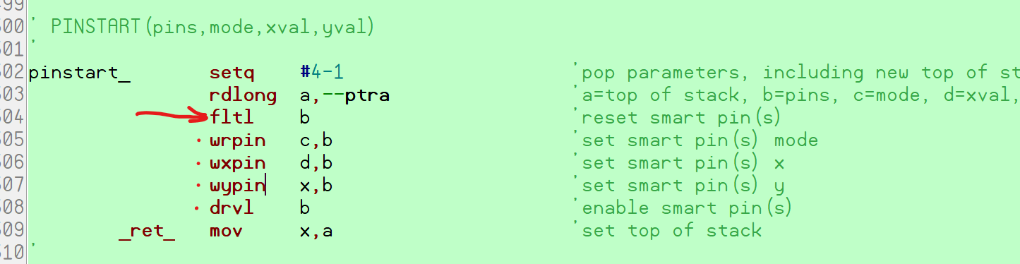

Shouldn't the first instruction in the sequence to setup the smart pin UART be fltl to release any previous smart pin mode? This is the code from pinstart() in the Spin2 interpreter.
DIRL does the same job.
Yep.
Kind of. After the ADDCT1, timeout holds the tick count of future 1 second trigger. The program loops one second at a time.
Yep, fetches copy of live value from sysclock tick counter, a hidden special register.
Yep.
Yes, can reuse each the moment each has finished.
I see now... It was late and I read that as drvl.
