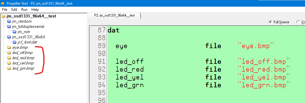

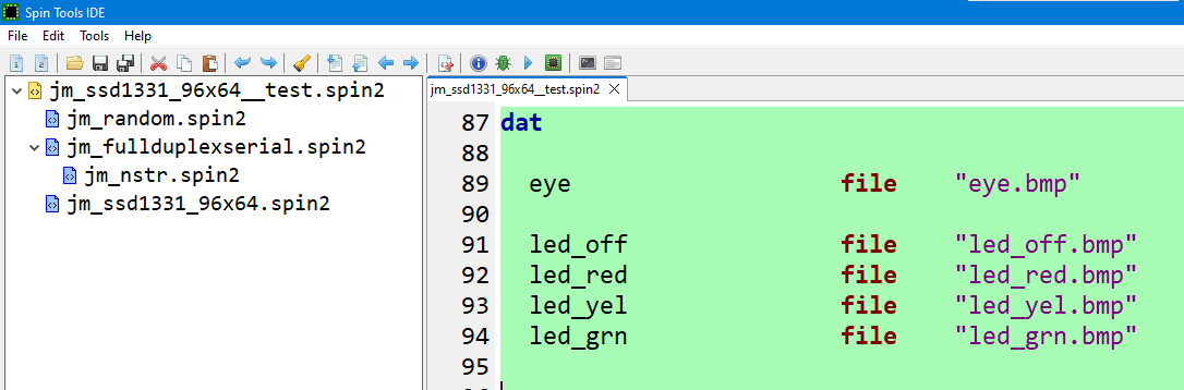

@macca Would is be possible for the for the Program Information dialog to show the memory usage of the selection from the file tree. ATM it shows the project usage -- it would be really nice if we could click through the files to see their contribution to the overall size.
It would be nice if the selection would change the memory usage display to reflect the object selected.
Thanks for considering.
A few minutes later... Maybe I knew this subconsciously, but I just checked and found Propeller Tool does this. Can we match that feature accounting for unused method removal so we know the actual memory impact in context of the application?

Would you consider showing elements included in a project via the file directive in the object tree? Propeller Tool does this.
Those elements are not displayed in Spin Tools.
That said, I did verify that they are included in the archive when created.
