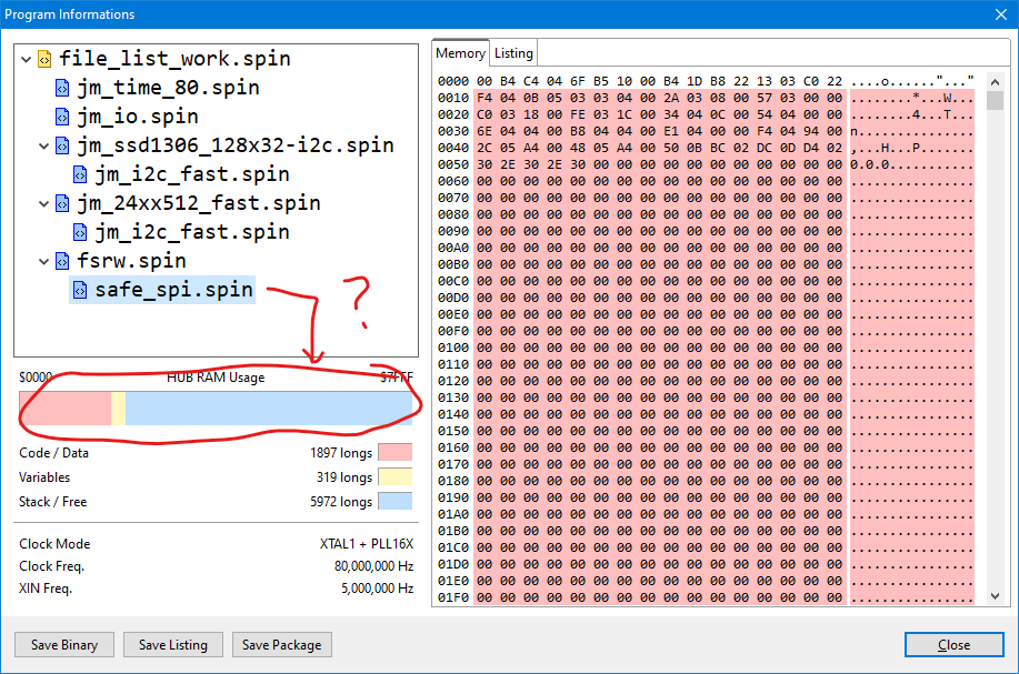

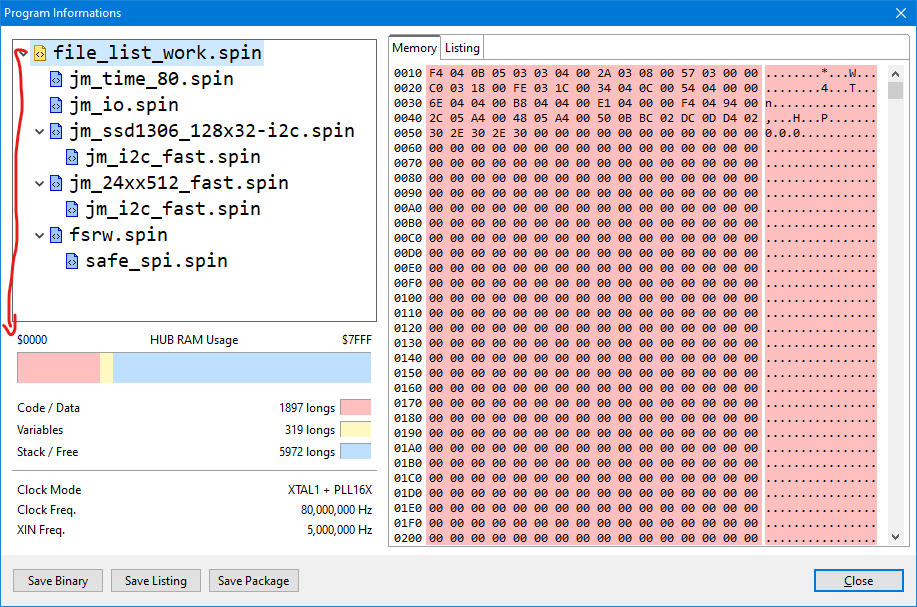

    @macca Would is be possible for the for the Program Information dialog to show the memory usage of the selection from the file tree. ATM it shows the project usage -- it would be really nice if we could click through the files to see their contribution to the overall size.
    It would be nice if the selection would change the memory usage display to reflect the object selected.
    Thanks for considering.

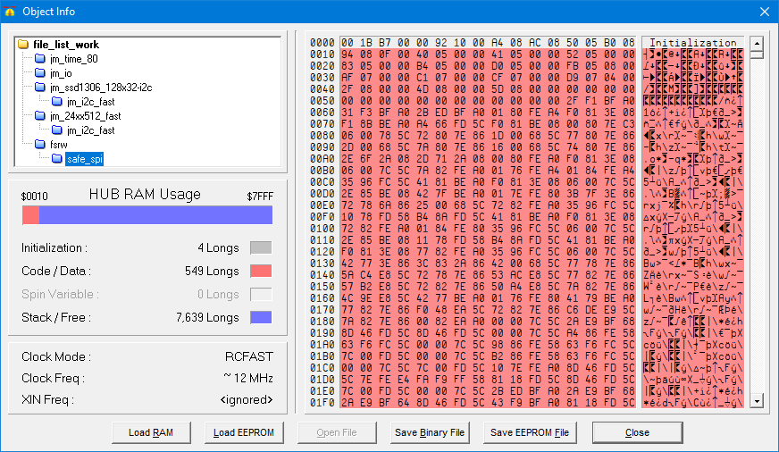

    A few minutes later... Maybe I knew this subconsciously, but I just checked and found Propeller Tool does this. Can we match that feature accounting for unused method removal so we know the actual memory impact in context of the application?

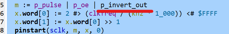

    @macca: Very small thing for a future bug-fix release. p_invert_out is a P2 symbol, but not recognized by the editor color highlighting.
