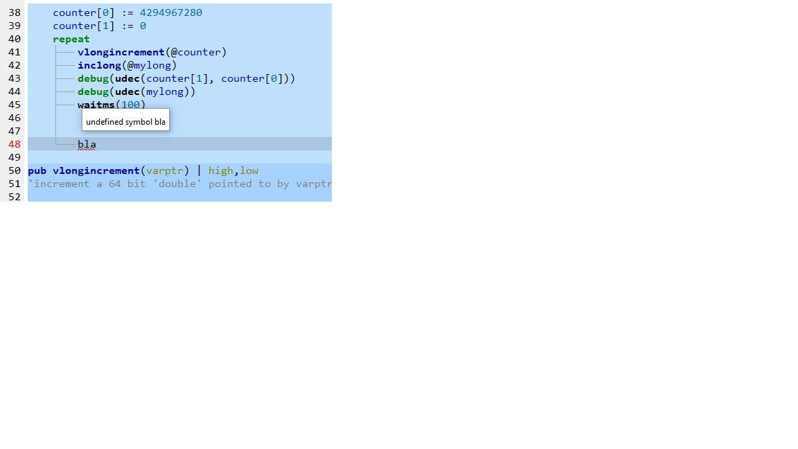

I changed the warning and error colors a bit, should be better, at least on the right-side bar.

Slightly revised warning and error highlighting colors
Just a note about the java runtime: Spin Tools uses its own private runtime, it doesn't use the system-wide runtime (it doesn't need to have one installed at all).
warning color at edge of edit window easy to see now

Hi,
just some feedback:
Because I wanted to be able to use graphical debugging, I now have tried Spin Tools IDE. (Windows 11, I am not comfortable with SPIN2.)
Areas of improvement seem to be:
With my 4K screen, the icons are way too small and I could not find a way to enlarge them. This has been discussed before, I see. You really cannot use them with the mouse. Perhaps just use text instead?
The error messages are not helpful: "Program has errors"
What I really like, are the quick and easy installing process and the outline window on the right side!!! Thank you very much for sharing!
Cheers Christof
Hi @"Christof Eb."
"The error messages are not helpful: "Program has errors"" - that's true, but notice that the editor cursor goes to the first error and you can hover over the underlined text and get more information about the error.
And what I really like is all the Pnut debug windows are working and they display really fast
Cheers, Bob
Ok, that was somehow hidden to me.
Will work on it, not sure how much it would take because I'm really bad at graphics but I'm looking at alternate icons sets as svg (vector graphics) that should scale perfectly.
That error should appear when you attempt to upload or get info (memory map and listing) with a source that has errors and, as already answered by bob_g4bby, after closing the dialog it should move the editor to the first error line. It is intentionally generic because there are other indicators that the program has errors, like the editor tab title should be red. I could add more details but in the end you still need to check where the errors are.
