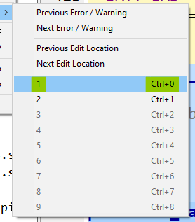

    There is a bit of a misalignment in the hotkeys versus the bookmark, i.e., bookmark #1 uses [Ctrl]+[0].
    Ah... yes, I must have mixed up the indexes...

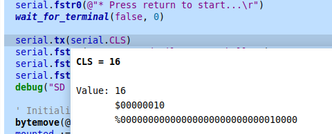

    Request: Would it be possible to show the value of a constant another object using the Hover Doc feature? The Code Navigation feature will take me to a child object, so I'm hoping showing constant values for child objects as well.
    That should work, unless I'm missing something:
    You can hover on both the object or the constant name and should display the value.

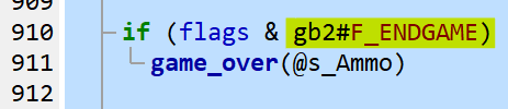

    You showed P2 code. At the moment I'm in the middle of a largish (~3800 lines in main app) P1 project. Navigation to the constant definition in the child object does work on the P1. Maybe this is an issue of # versus . in the object#constant expression.
    Just to confirm, Hover Doc works for constants defined within the P1 file that is the active edit window.
    Ahhh... yes, I forgot the separator for P1 constants. Will fix it.
