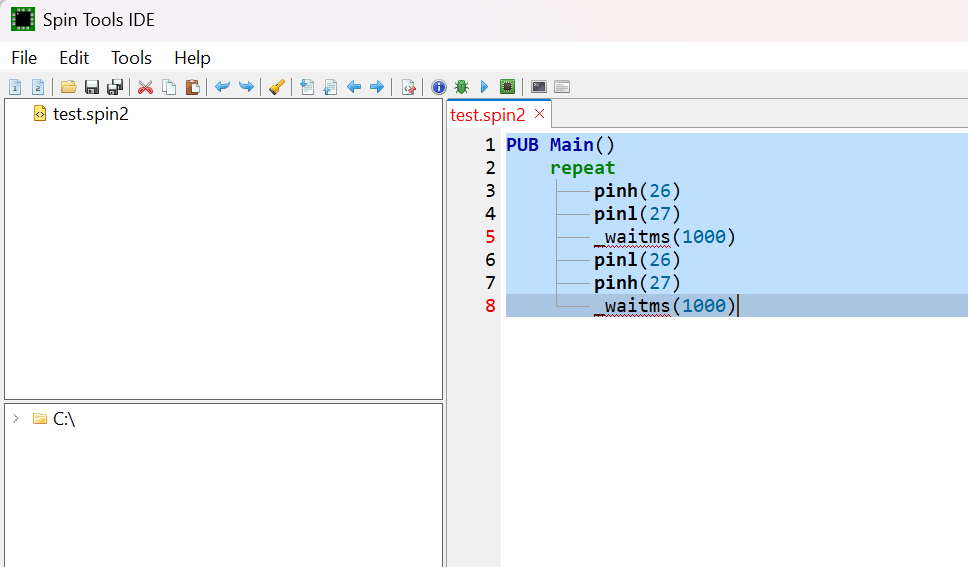

I'm wondering if the toolbar buttons should be bigger...
Just a thought... They are tiny on my Windows machine right now...
Windows does have this new DPI thing going that can mess up some programs that don't handle high DPI.
Maybe that is what is going on here?
Almost certainly.

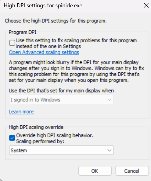

Honestly I don't know how this High DPI thing works (either on Windows or any other OS) since I don't have any high resolution monitors (that is higher than the standard 1920x1080).
At minimum, it needs a set of icons resized to match the "zoom" factor applied to the application, if I'm not wrong. All icons are bitmaps so the resize will be blurry at best.
I see that there is an override setting in the Properties -> Compatibility tab of the desktop shortcut, some "AI Overview" tells that the Override DPI settings should do something, does that have any effect ?

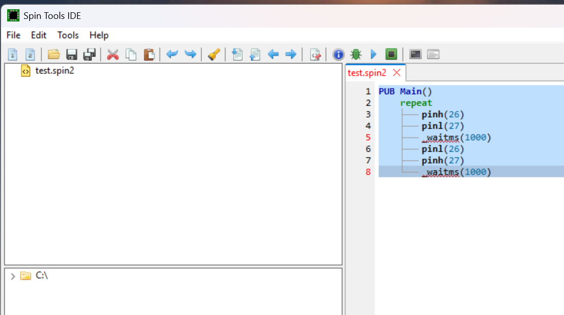

Ok, this does make them a little big bigger. Maybe good enough...
Windows does the scaling on its own, good.
Yes, the icons looks good, a bit blurry maybe, but I don't think I can do better by scaling the 16x16 bitmaps with Gimp.
