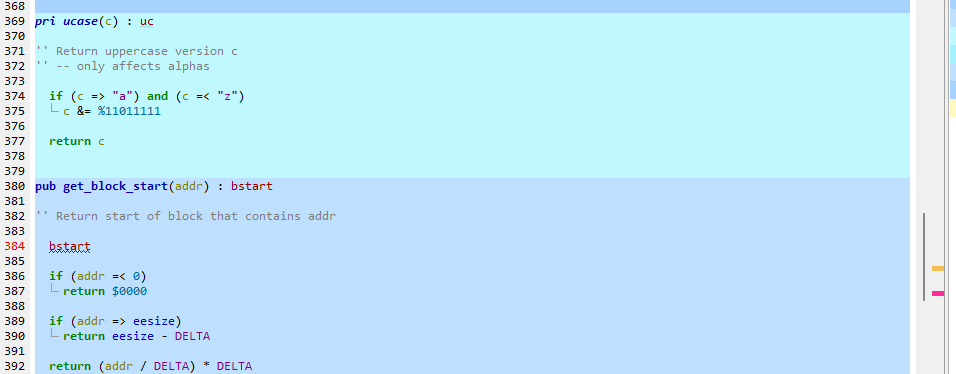

I changed the warning and error colors a bit, should be better, at least on the right-side bar.
I think I'll start working on the color theme configuration.
I found a place where I missed to add an error dialog, that would explain why the application closes silently when there is an error reading the preferences. Should also help with other issues.

Slightly revised warning and error highlighting colors
Just a note about the java runtime: Spin Tools uses its own private runtime, it doesn't use the system-wide runtime (it doesn't need to have one installed at all).
warning color at edge of edit window easy to see now

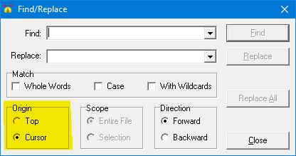

The next time you're looking at the Find/Replace dialog, could you add the start point option as on the Find/Replace option in Propeller Tool? It should default to cursor, of course, but I find it convenient to switch to top when I want to locate a global variable definition. Thanks.
