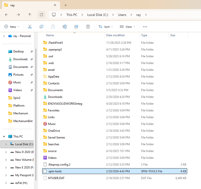

    Hey Macca,
    I am now in Italy just like you, in Cortina for the Olympic curling HF camera's.
    I try you explanations, but do not work.
    I find strange, I get it working on an emulation win 11 pro on my mac with latest updates on win11.
    But it didn't work on my i7 HP win 11 pro laptop....
    Guess I have to talk to myt IT staf.
  • RaymanRayman Posts: 16,056
    It's been a long time since I've seen Windows really block something...
    But, back then think the trick was to copy onto removeable media, maybe from a different computer, first.
    Windows does seem to track things that are downloaded from the web. But, once coming in from removeable media, like USB drive, think it loses track...
  • Find it !
    In User map I have ".spin-tools" hidden file.
    When removed, the last version is running
    edited 2026-02-21 15:16
    @Ltech Good find! Was thinking that all settings were in registry, but seems they are in this file instead...
    Wonder if that's the issue for @JoshW as well...
    Maybe this happens when trying to go from a very old version to a new version?
    Imagining that the very first thing Spin Tools IDE does is try to open and process this file...
