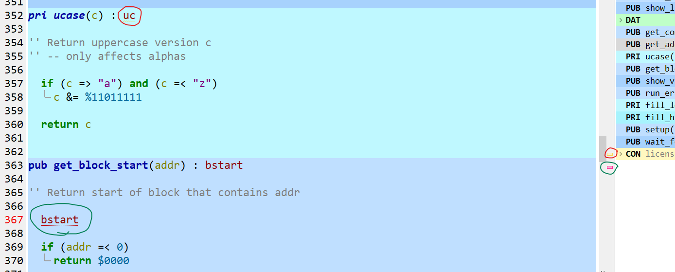

Just noticed the "Case Sensitive Symbols" option...
Guess that would mean it would treat all variables and things like C does, right?
Right.
I really like the idea of that option. Think it would break all existing code though...
Not all existing code, when I tested the libraries and examples I found some files with mixed case identifiers, like variable, Variable and VARIAble, but most code works.
The fixes are also easy because the code suggestion prompts you with the declared identifier (CTRL-SPACE at end of the variable name).

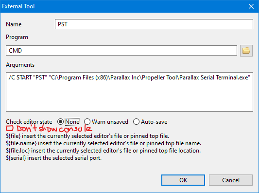

Small thing (hopefully)... Could there be an option on the Tools editing dialog that stops the console window from opening? Once I have things setup, I don't need to see that again and just find myself having to close it to regain screen real estate.

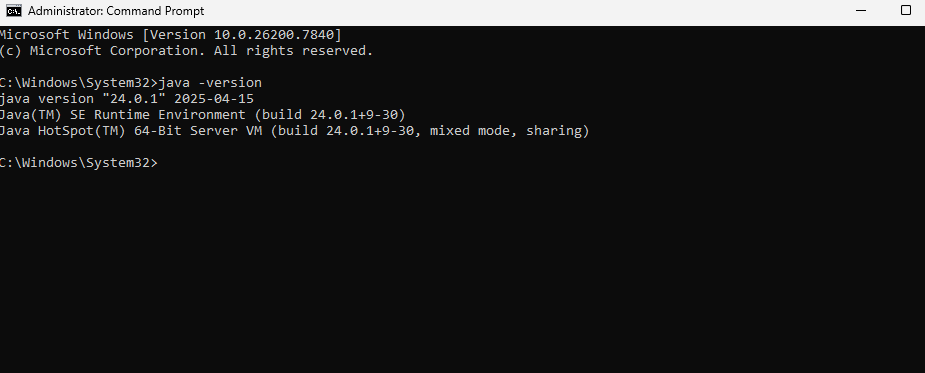

Hello @macca, Amazing Creator of SpinIDE,
and the Parallax Community,
I am currently running a Windows 11 machine and have successfully used SpinIDE in the past. However, recently I have not been able to get it to open.
Here are the steps I’ve taken:
Downloaded the latest files
Unzipped the folder
Double-clicked the .EXE file
When the blue Windows security window appeared, I selected “More Info” and then “Run Anyway”
I also tried right-clicking and selecting “Run as Administrator”
Despite these steps, the application will not open.
I’m not sure if I have missed something in the process or if there is a compatibility issue with Windows 11. I would greatly appreciate any guidance on what I may have done incorrectly or how to get back up and running with this great tool for use with Parallax Inc. products.

You can try to run the command line compiler spinc.exe: open the command prompt window, change to the spin-tools directory and start spinc.exe, it shoud list the available command line parameters.
If there is something wrong it should write an error message. It is not exactly as running the IDE but should at least exclude some things.

I double checked my Java files, picture here
Right.
