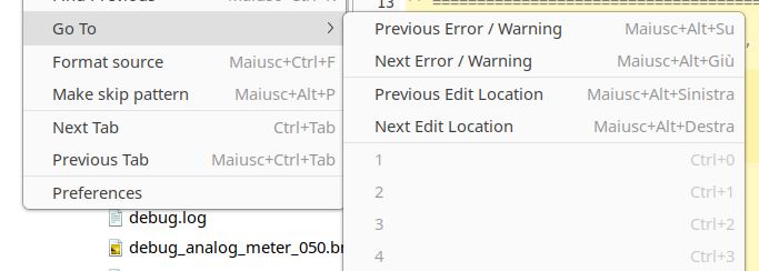

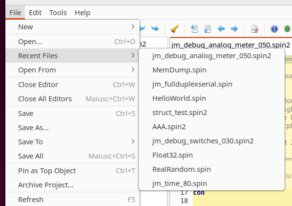

The menu was rearranged a bit to be more compact:
The New file menu was moved to a sub-menu with the items better grouped. There isn't anymore the New item alone which created an empty source (which caused an error for P1 since it doesn't have any Spin method), I think it is better to always start from a template.
The recent files list was moved to a sub-menu below the Open item.
Tthe Bookmarks menu was renamed to Go To and added the missing navigation items.

This is probably an idea that only I care about... but I'll toss it into the ether, anyway. In the File menu I would love to have New (From P1/Object template) with a similar item for the P2. I have templates for applications, and templates for objects. Of course, the Preferences dialog would need updating to add paths to the object template files.
Can I actually program in C from Spin Tools? Not that I will, but I'd like to experiment. I clicked on New (From P1/C template) and tried to run (without saving). I got stuck on the downloading dialog (it would not close manually), so I had to force a shutdown with Task Manager. It did work when I tried again and saved the file, so maybe adding an error dialog to prevent unsaved files from sticking things.
I tried this, but no joy -- it doesn't like the use of time.pause().
#pragma target P1 #define _XINFREQ 5_000_000 #define _CLKMODE XTAL1 + PLL16X #include "jm_time_80" void main() { // initialization dira[26] = 1; for(;;) { outa[26] = 1; time.pause(500); outa[26] = 0; time.pause(500); } }Again, I'm not going to be coding any of my work projects in C, but I'd like to get better at it.
Could be added, maybe with a bit redesigned menu, it is getting crowded.
