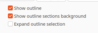

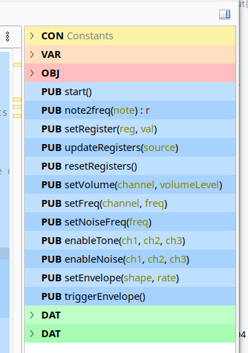

Released version 0.50.0
A lot of updates with this version.
Updated the Spin2 interpreter to PNut v52, including the new functions/keywords, the next/quit level addition, DEBUG_END_SESSION and the new commands for the TERM debug window.
The TERM debug window also have the SCROLL command implemented as suggested by @JonnyMac :
The direction can also be specified as a word up, down, left, right to have a shortcut to scroll the entire window with just
scroll up. If bgcolor is omitted it takes the window background color specified in the setup command. Note: this is not (yet) implemented in PNut.The outline view now can display background colors like the editor (can be enabled in the preferences):
And since we are at, there is a new button on top to temporarily toggle the view visibility to have more editing space.
The Editor preferences has a new option to disable the automatic expansion of the outline tree (sometimes may be a bit annoying).
The program launchers now are using a fixed list of files to configure the Java runtime, this should prevent the load of old versions when updating to a new release.
The problems with unplugging and replugging the serial adapter on Windows should be fixed.
Also should be fixed the issues reported by @wummi with the pointers operations and LSTR.
The cursor position in the edited files is now saved across sessions, this includes the open tabs and the last recently used files.
