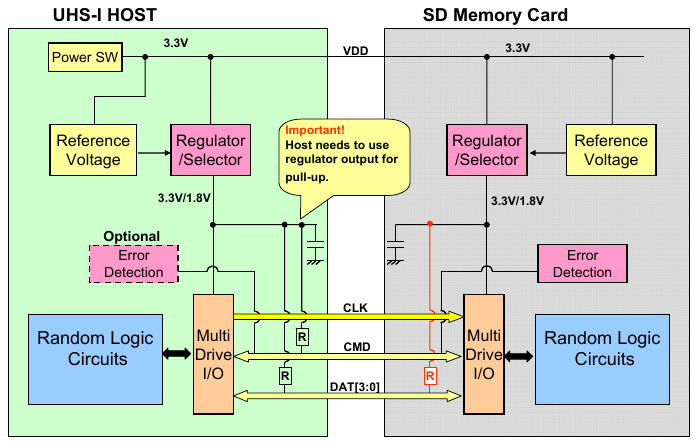

    @evanh Looks like that was it...
    FatFS works from boot with this change to line 550 in sdmm.cc:
            //spm_rx |= P_SYNC_RX | P_OE | P_INVERT_OUTPUT | P_HIGH_15K | P_LOW_15K;  // rx smartpin mode, with 15 k pull-up
            spm_rx |= P_SYNC_RX | P_OE | P_INVERT_OUTPUT | P_HIGH_1MA | P_LOW_FLOAT;  //  pull-up
  • evanhevanh Posts: 17,112
    edited 2025-08-29 14:32
    You do know that's a work-around, right? It overpowers the incorrectly wired R24 pull-down on P58 that should be a pull-up. I expect you to correct the schematic and fix the already made modules in the medium term.
    PS: The only reason, I think, that FSRW works for you is because you're using the broken sdspi_bashed2.spin2 driver that doesn't ever do a card busy check. Which is also why FSRW needs multiple attempts to get anything done.

    @Rayman said:
    @evanh what’s wrong with the work around?
    It ain't gonna be standard issue for a starters. It'll be up to you to add the workaround each time there is an update to includes.
    Not sure how changing the pulldown would affect other parts sharing that pin…
    The pull-down is a mistake. A tad surprisingly, the Parallax board have no resistor at all. So my programmed pull-up is actually needed.
    Everything except the CLK requires a pull-up.

    The fact that the Eval and Edge boards have no pull-up resistor present on P58 means you can remove the Swap's R24 and be reasonably confident of future drivers always handling it.

    Removing R24 seems to make FatFS happy. But, it turns off the associated LED that was kind of using as power LED.
