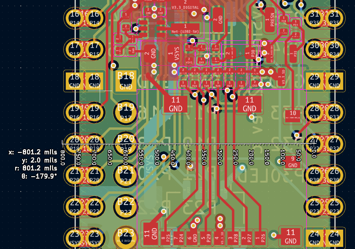

Great for breadboard use or as an upgrade for designs using FLiP or a DIP 40 P1. Will be slightly wider than a FLiP or DIP 40.
USB-C connector with data pins P62, P63. Reset signal on USB SBU pins. For now it would work with special prop plug with type C output. In the future we could have a native USB bootloader. I think an FTDI chip would fit on there if desired.
At the other end maybe a 4 pin JST for I2C. (QWIIC) If the PCB is 0.8 to 1mm thick then an edge connector for an HDMI cable is possible. Or another USB-C connector so the Sunnyside and Prop-Plug-C are the same board.
Power supply would generate the 1.8v from the 3.3v since the P1 only receives 3.3v. If used in place of a FLiP it would accept 5-9v from the appropriate pin.
Not routed yet, but I think it's possible with 4 layers.

How much total IO do you intend to bring out? Looks like it could do something similar to P2-EC32MB ~40 GPIO pins or so, maybe a few more.
This is my take at a low cost P2 board.
Mostly Pi Pico compatible pinout. It's a bit longer.
Single sided pick and place (except PSRAM. Although overclocking might not be great with capacitors on 2 edges only.)
Breadboard compatible .1" through hole headers. I think it would be possible to bend some of the top pins to connect to the castellated edge and get all of the pins.
Uses the P2 internal crystal oscillator to save a few cents and lower standby power.
USB-C connector for programming. I think a native USB bootloader is possible. Until that happens, those pins can be used for the usual serial programming.
A second USB-C connector to program another board or connect to USB devices.
4 layer board without via-in-pad.
7 pins lost due to lack of space to route them. (Pins 0-3, 38-39, 47)
10 pins PSRAM (48-57)
4 pins flash (58-61)
41 total GPIO, including P62-63. 29 on a breadboard, 33 castellated. (Pico has 26)
2 pins dedicated to QWIIC connector. (32-33)
2 EVAL connectors, 1 with 5v power
Pins starting with B are the inside columns.

Is .1" inch pitch important? The through hole pins on the pico style are .7" apart. The castellated edges are not on a .1" grid.
Do you want the one with 2 EVAL headers (more GPIO) or the one with the microSD?
Do you want 16MB PSRAM? With a smaller flash chip it's possible the PSRAM could fit on top. I designed it so it to be a usable basic board with the top side parts only. I chose the large PSRAM chips so they could be added later.
There are a few things I'm not quite sure about. The bypass capacitors on the top are only on 2 sides instead of all 4 like the Edge. I added additional capacitors on the back side in case they are needed. I won't know if they are really needed until I build some of these. In practice it will depend on the clock frequency. Even 2 layer boards are fine at 250MHz. 340MHz might need a well designed 6 layer board. The boards I've shown here are low cost 4 layer boards.
The 6 small castellated rings, they might be too small for reliable castellation.
It's a native USB interface which will need a USB bootloader that does not currently exist. There is code for a USB serial device. Or a prop plug that outputs to a USB-C connector. It will be possible to program it using the DIP pins.

So basically "as many breadboard friendly pins as possible." The Pi Pico is fully breadboard compatible. The castellated edges are .1" pitch, but .826" center to center. Because the P2 is such a big chip I had to remove some of the through hole pins. I think I can get those 6 castellated pins to the breadboard with some creative bending and soldering of the pin headers.
