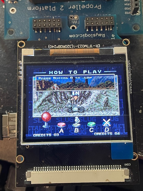

  • RaymanRayman Posts: 15,644
    Works with LCD6 too (of course)
    480 x 640 - 124K

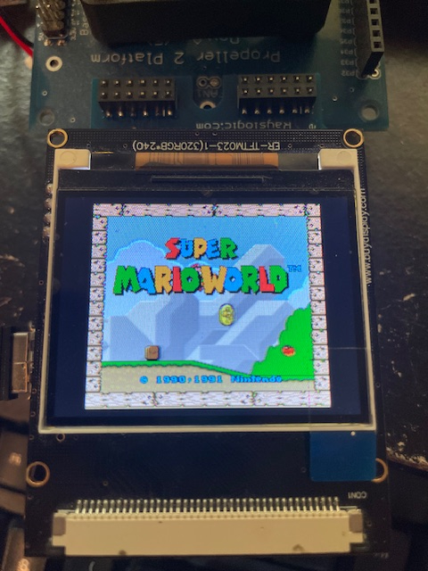

    NeoYume was easier.
    It just worked...
    480 x 640 - 177K
