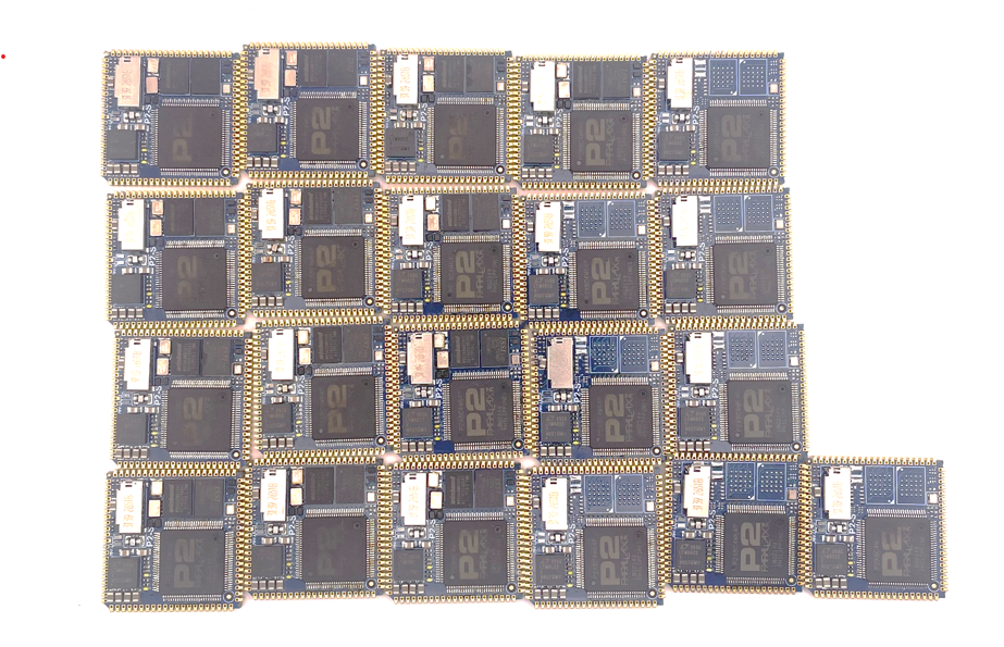

    Working on building up some inventory.
    Some of these were going to be "Core" version without some parts, but have since decided that is a bad idea (because would compete with Parallax, and probably lose :)
    New boards with through hole PLCC-84 socket are here.
    Should be ready to go soon.
    Think if these all sell in a reasonable amount of time, will get 100 assembled.

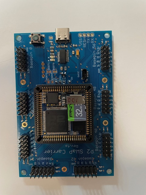

    Assembled the first new SWaP carrier board. Seems good so far...
    Added a vertical QWIIC connector after seeing one on one of @JonnyMac boards...

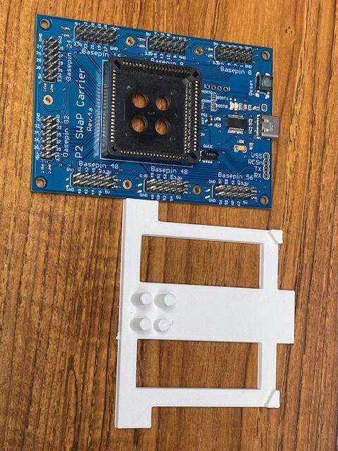

  • RaymanRayman Posts: 15,842
    3D printed a fixture to pop out the stamp using the holes in the socket. Uses three of the four holes... Fourth has parts on bottom of board and not sure want to be pushing on them..
    Seems to work. Save one from having to buy and extractor maybe...
