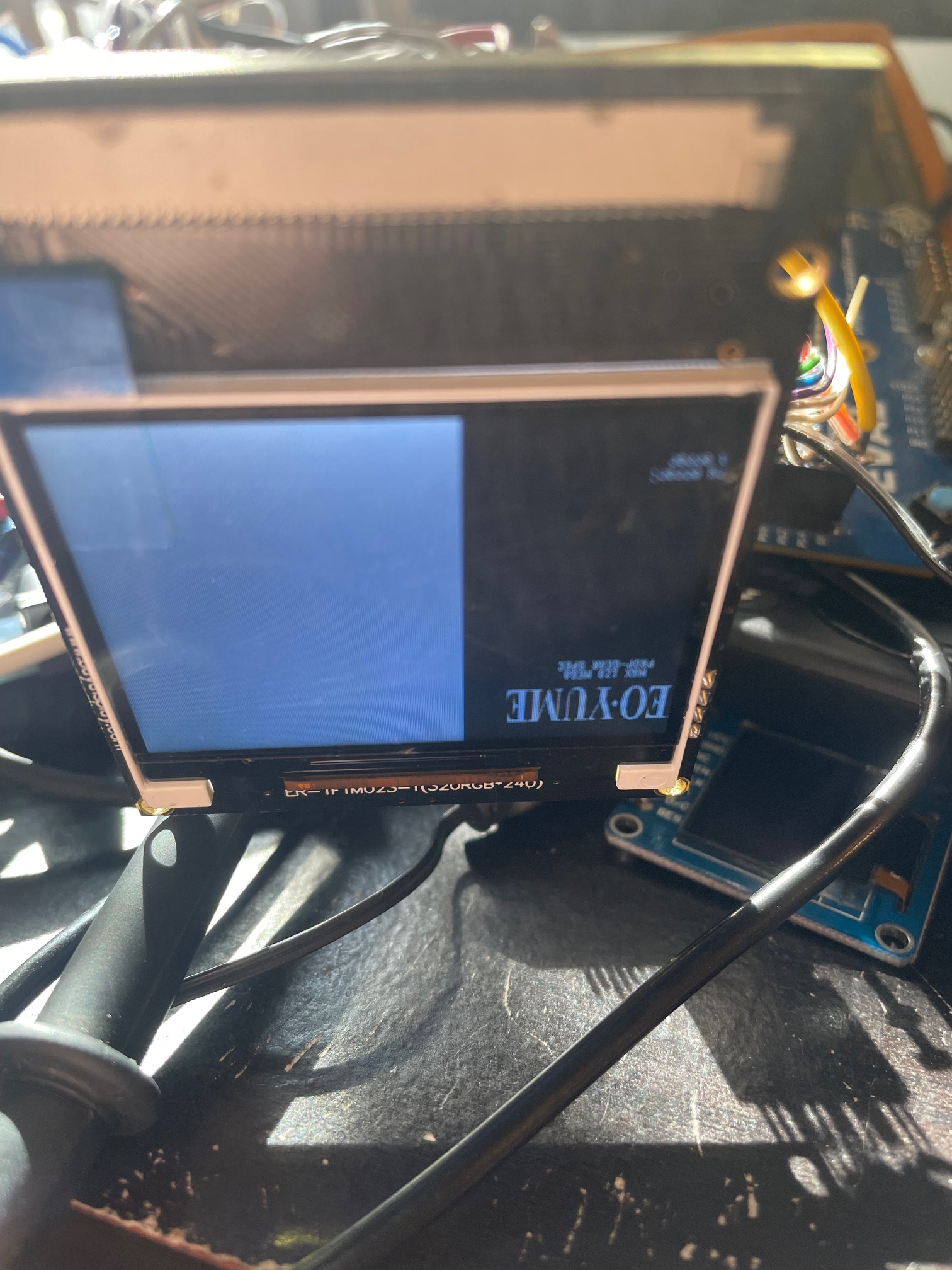

@Wuerfel_21 Regarding ILI9342... What is the order of the 8 pins on the basepin?
This order doesn't seem to work:
HSync, VSync and 6 data pins
@Rayman
No, that's definitely it. More likely: incorrect DOTCLK or serial connection.
The latter you can test if you have a driver for that specifically.
Or missing backlight pin (symptom of this is obvious).
Also, enabling RGB mode can cause the LCD controller to hang if there's no dot clock, so sometimes a power cycle is needed when experimenting.
What software are you testing with? Always use the latest version. I also don't think I ever tested the data bus not being at pin zero, might be missing a pin offset somewhere, so try that.

Ok basepin is 16, maybe that’s the problem
The backlight enable had me for a sec. They should have put a pull-up on that…
Problem might be with memory config... Think that has to work for NeoYume to work...
The menu should pop up regardless (unless RAM pins are interfering w/ something else)
Also don't forget the audio pins, make sure they're not set to some otherwise used pin.

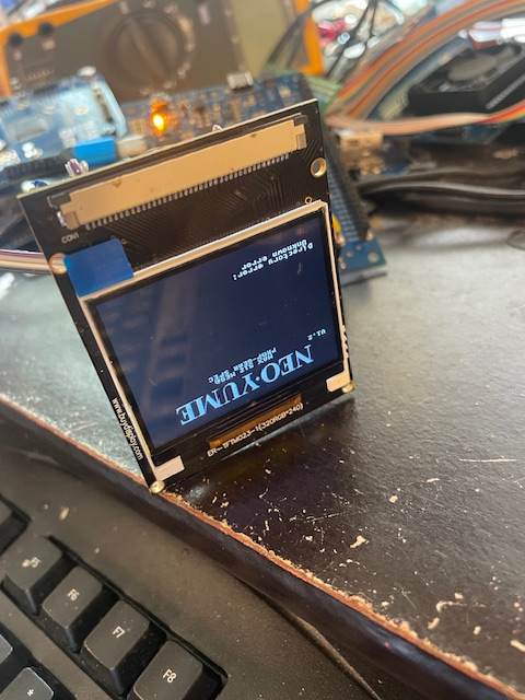

Well, guess this counts as progress...
Better with newer NeoYume.
(Also moved to basepin P16)
That reads like "V1.2", are you really sure about that? 1.4 should be current, always grab from github when in doubt.
(Also the screen being upside down like that is normal, that's just how it's mounted)
