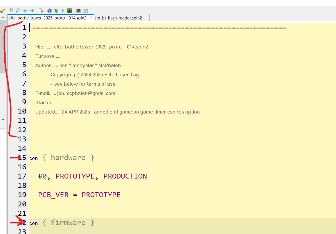

  • JonnyMacJonnyMac Posts: 9,408
    Just found a small "gotcha." I changed the font size for the editor and it seemed like the editor then mixed fonts.
    I ended up closing and re-opening the file to get everything tidy again.

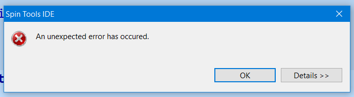

  • @macca
    Just downloaded spin tools again. Got the following error please see attached. Sent same to your website.
    Thanks
    Martin
    1747 x 1020 - 152K
    1546 x 1191 - 328K
    2.jpg 152.5K
    1.jpg 328.2K
  • maccamacca Posts: 902
    One of the files opened in the editor has an extension other than .spin .spin2 or .c ?
    Because seems that it opened an unknow file (the editor should prevent that but for some reasons it failed).
  • @macca
    How do I fix this.
    Thanks
    This occurs when I double click on the icon to open the ide.
    Right, delete the preferences file .spin-tools (note the leading dot) in the user's home directory.
    Alternatively, open the .spin-tools file and delete the "openTabs" property (if you are familiar with json file format) but may be better to delete the file.

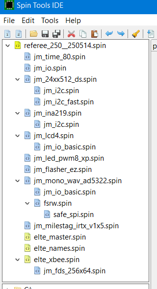

    One of the things I appreciate about Propeller Tool is the color-coded folder icons. Could we have that in Spin Tools? It's helpful on big projects where I use libraries that are local and in my master library folder. Yellow indicates a local file, blue indicates something in another folder. So it looks something like this:

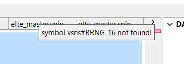

    Found a small gotcha: The error indicator at the very top of the strip allows hover (and shows the error), but clicking results in an error dialog.
    Would it be possible to add the line # of the error to the hover hint?
  • @macca
    Howdy, I deleted the .spin-tools file. This is also after downloading your newest version of 0.47.4. Got the same error.
    Not familiar with the json format. Got the same error. Any other suggestions?
    It does appear to work even after I "ok" out the error message.

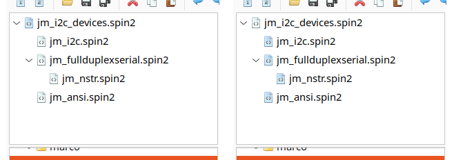

    Yes, I think it can be done, I have a small number of color variants (two actually, the current white-ish and a blue-ish alternative), here how it may look :
    I think the left image may be better, need to also change the icons in the file explorer to be consistent.
    Forgot to tell, make sure you exited the program before deleting the file or it will be recreated.
    It if works, you should have a tab with the incriminated file open, you may just close that tab and it should not appear again.
    Anyway, I would like to know what file caused that error, AFAIK it should be a file without a known extension (.spin .spin2 or .c) but I don't know how it was opened, the editor should prevent that.
    I tried but can't reproduce, can you show the details ? It should report the exact error and location in the source.
    Yes, I'll add it.
    If it matters, I prefer the image on the right where the external files (not in the project folder) are shown in blue. And I don't think you need to change the file explorer.
    I tried to reproduce, too, but couldn't -- even if I created errors on the first and last lines of code. If an error pops up again I'll open the dialog and post the details.
    Yes, I'll add it.
    Thank you.
