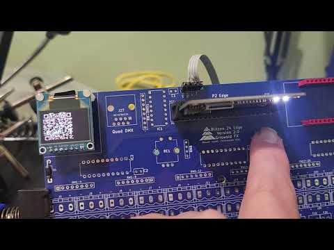

  • It's that time of year again! I have worked up a version 2 of the Blitzen 24 Edge. These are the fixes and additions.
    1) Crosstalk between the ethernet and outputs 16-24. Now using 4 layer board with ground and power planes. (fix)
    2) Reset of the P2 does not power cycle the SD card. Now using the 5V regulator enable pin with a switch to powercycle the Edge. (fix)
    3) Not enough thermal dissipation on power inputs. (fix)
    4) OLED display screen burn-in. (fix)
    5) Screw Terminals on power inputs. (new)
    6) Rotary Encoder with button for diagnostic menu selections. (new)
    7) Remove need for 12V/5V jumper and remove optional separate power input for controller circuitry (new)
    8) PCB now has standard 4MM holes for standoffs.
    Also, this is a new layout using KiCAD. I love KiCAD. Unfortunately I had to increase the board size by 5MM. It may require some modification to the ChannelMaster enclosures to fit properly.
    Should be testing next weekend.

  • Well, the 4 layer board almost solved my "glitching". Whenever I started the cog that outputs P32-P39, it caused interference (somehow) with the ethernet which resulted on all outputs. I believe this caused issues with ethernet, even though this is a 4 layer board and all traces for ethernet are on the top (red) side of the board. The fix for this was to use less drive on both ethernet and pixel output. I don't understand how those two could interact, because there is a solid groundplane and powerplane between them.
    The only remaining issue I have is Port 24 (P39) It glitches severely. Almost like it has a bad connection. I replaced the driver IC to make sure it wasn't a problem and reflowed the solder joints. Using a bodge wire solves the problem. Also placing my finger on the bottom of the board just below the edge connector where the P32-P38 traces are solves the issue.
    Port 24 (P39) is the victim with the aggressors are P32-P38. I just can't figure out why P0-P15 are A OK, but these aren't. Maybe it is the proximity of P32 to the ground side of the reset button.
    If anyone could tell me where I messed up, I would greatly appreciate it.
  • RaymanRayman Posts: 16,460
    edited 2024-09-16 10:26
    Is p39 driven directly or though a pull-up ? Maybe adding a load resistor close to the chip it’s driving helps? If it’s a slow signal there maybe some capacitive load too…
    Also make sure it’s not a power supply issue…
  • Although a 4 layer board has better shielding against capacitive crosstalk it means less distance to the ground plane and therefore higher parasitic capacitance and higher peak currents when signals are switching. And you can't shield magnetic cross-talk easily. So even with 4 layer boards it's sometimes not good to route sensitive signals with long traces in parallel.
    So with "ethernet signals" you mean the data bus going to the WIZ module? Reducing the drive strength on the data bus generally helps as you already found out. On my CNC board I had to insert series termination resistors between the P2 and the SPI bus lines. This reduces the slopes of the switching edges and reduces crosstalk and ringing. Unfortunatelly the P2 has no series termination in the range of 100 Ohm built into the smart pins. the 1.5k resistors are a bit high and might slow down timing critical signals too much. So I inserted hard wired 68 Ohm resistors which give a good match to a 100 Ohm line together with the ~30 Ohm internal drive resistance of the MOSFETs.
    I'd try to analyze the signals with a scope so you can optimize the terminations to get the optimum minimum edge slope vs. minimum delay balance.
    Are the signal layers next to each other?
    If so and doing it again, might want to put a ground or power layer between them...
    P39 is directly driving a SN74ACT241N. It is a non-inverting buffer used to act as a buffer and bring the output up to 5V. The signals going into this IC are 800kHz. It just seems really odd that I have two other circuits exactly like this one that has no problems. The only difference is all 8 of the inputs to this IC reside on the same side of the board, whereas the other two IC like this have 4 on top and 4 on bottom.

  • I think, debugging this with an oscilloscope is the only way to avoid blind-guessing and shooting into the dark. With a scope it should be relatively clear to identify the reason and a countermeasure for the interference. For example, capacitive cross-talk can be idetified by an overshoot at the victim signal while the agressor has a rising edge. If it's a supply problem there should be a downward dent in the victim signal, instead.
    It's difficult to trigger on the actual error condition in real data streams, though. I'd suggest generating worst-case patterns, for example output rising edges on all agressor signals simultanously with different phases of the victim signal.
    Placing my fat finger on those 6 lines where I placed the arrow for the aggressors makes the problem disappear
    Fingers add a bit of capacitance and a weak pullup or pulldown resistor. That can dampen crosstalk or ringing. I also often had the case that touching a signal with the scope probe does cause the problem to go away. This is of course annoying while trying to debug something. But you could still see over/undershoot or crosstalk, it just becomes smaller.
  • @cgracey saved Christmas! WRPIN ##$00000900 is the secret sauce for curing my glitches on P39! Thank you so much for your time and advice today!
    So $900 is "drive high 1.5k" and "drive low 1.5k", IIRC? Good to hear you got it fixed!

    Well, now that I have the outputs sorted, thanks to Chip, I am on my way to a 2.0 release. I am naming this release "Rocklin". The 1.x was named "Music City", where I designed it. I want to keep with a theme of all the places people are at that helped make this thing a reality.
    The rotary encoder selects between 3 menus.
    1) Displays IP, Ethernet Status, E1.31 Status, Dropped packets, Decoded Packets, Mac Address
    2) QR Code with a link to the Web Interface.
    3) Software Version.
    The OLED now powers off after 30 seconds. When the rotary encoder selects a new menu or the button is pushed, it will power back on.
    Here is a quick video of me using the new features:
