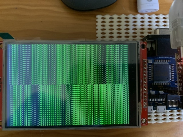

4.0" TFT SPI 480x320 LCD ST7796 -Spin2 and PASM Driver & Demo
Touch and non-touch versions
Previously "4.0in TFT SPI 480x320 LCD ST7796 Driver and TCS2046 touchscreen support"
P2 Quick Byte
https://parallax.com/320x240-lcd-driver-for-ili9341-controller-and-xpt2046-touch-screen/
Update 10-Mar-2021 v3.01 Now supports many SPI LCD boards of various resolutions and optional Touch Panel code from Mike Roberts, and includes changes by Greg LaPolla for 3.2 in 320x240 ILIp341 SPI LCD

    The ST7796 registers are the same as the ILI9163 so i just tried my code with slight mods. Basically works :sunglasses:
    Here are a few measurements...
    Powered from 5V = 113mA
    Powered from 3V3 = 59mA (vreg not bypassed on LCD board) - DO NOT power (or GND) from a P2 pin! (This works for the 1.44" LCD)
    LED 2.4mA @ 3V3 so can be safely connected to P2 pin
    Currently i am not using the MISO pin so there are only 6 IO pins being used.
    You may have noticed i need to rotate 90 degrees and invert. The screen pixel size doesn’t seem to be working as it should either. But this was a 5 minute job and I didn’t really expect to be able to use the ILI driver so easily. I will try and make it as parameterised as possible.
    Ok, now have mirroring fixed.
    Next is to convert some lcd commands to use 16bit parameters for row and column addressing etc (was 8bit for the smaller LCD).

    Now working on P42-47 on my RetroBlade2 (pic on first post)
    edited 2020-11-08 02:16
    Draw circle bug fixed. See first post for v207 code. :sunglasses:
    edited 2020-11-10 02:07
    Demo updated to v208 that includes a full screen text demo..
    20 lines are 80 chars of 6*8 font followed by 20 lines of 60 chars 8*8 font
