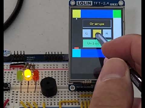

  • @ManAtWork Here is a test video of the driver with my framework:
