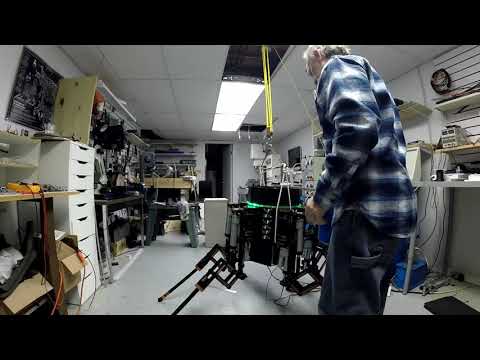

  • Yesterday was spent doing mechanical calibrations on the legs. I ended up doing it several times as later adjustments affected earlier changes. So I had to stop and figure out the right procedure for making adjustments.
    The only mechanical adjustments available are on the femur and tibia linear drive motors. The output shaft can be manually turned to shorten or lengthened and that affects the leg positioning. Ignoring a couple of hours of changes that I made initially that made the problem worse, I finally figured out the right way. Calibration requires adjusting the tibia first against a known angle and follow that with the femur.
    I adjusted the tibia by using an electronic protractor to get the angle the leg supports were at (this would be normally vertical) and adjust the tibia until it read the same angle (so they were basically in line with each other). Adjusting the femur was done by shortening all the femur drive shafts to their minimum position initially. Next was taking an interior angle off the parallelogram on each leg when all the slack is taken out of the leg. Once I knew the largest angle, I adjusted all the other femurs to get the same angle.
    I found that leg #6 was still not not quite right. I determined the leg was 1/4” shorter than the others. Since all the parts are interchangeable this should not be happening. It turns out the leg bottom impact assembly was actuated all the time, hence the 1/4” difference. I disassembled the part but didn’t find any thing obvious so far. It was getting late so today I will figure that problem out too!
    Also on the agenda is checking the leg angle limits for tibia and femur against the programmed values and then verify the electronic calibration values. If any leg is still different than the others then a programmable ‘fudge factor’ will be used to make sure it gets into alignment with the other legs.
    Bob
  • I couldn’t find anything mechanically different on Leg #6 but the centering o-ring was pushing the leg up. It’s supposed to be a tight fit to keep the leg from moving too much so I took about 0.005 off the groove the o-ring rides in using the lathe. That seemed to help a lot and the leg settled into the expected position.
    The next step was extending all the legs to their maximum position. This lifted the robot body off the test stand and put all the weight on the legs. I found that legs #1, 3, and 5 were carrying all the weight and 2, 4, and 6 were not fully extended. 2 of the legs were touching the ground but the leg wasn’t compressing the bottom impact spring. Leg #6 was 1/8” above the ground. I measured the angles on the legs and found there was a 5º difference in the legs. I suspected that the encoder maximum setting was stopping the legs from going as far as they needed to. I tried increasing the encoder maximum and found that improved the position but the linear motor reached its movement limit. This meant extending the motor output shaft to permit a longer movement. So this became a combination of mechanical and encoder changes until I could get the motor to extend the leg to where the bottom impact spring fully compressed but didn’t cause the legs on either side to lift up. This took a lot of trial and error to slowly find the right combination. Then repeat the process for the other 2 legs. That took up most of the time in the shop today!
    The end result is all six legs are firmly planted on the ground equally!
  • I felt that I was far enough along that I could remove the test stand. Boy was I wrong! There's a reason I named this video Hexapod Fails!
    It took a while to recover, no damage to the robot but some of the motors were getting too hot to touch. I also managed to get some rope burns out of this, time to get a better rope, very hard to hold onto poly rope without it slipping.
    I have a list of issues to correct, first off I'm writing a routine to validate the IK angles are not out of range (which is what happened when the coxa motors suddenly went to one extreme. After watching the video I figured out that I was only applying the IK routine once at the beginning of the move, it should be applied more frequently as the leg is moving to get everything in synch. That is why the leg tips were sliding on the floor.
    Anyway I learned a few new things today, mostly what not to do! Back to the drawing board again. This video was taken using my GoPro, the wide angle lens is almost too much, I liked my old Cannon G12 better for video. I may have to get another one like that again. The Olympus is nice but the focus tends to jump around which makes it difficult to get a good video, I have ended up deleting most of the files I created using it.

  • I take back where I said no damage from stalling the motors. I was checking wiring to fix a power wiring error (I can turn the computer power on without having the key switch on) when I found the the battery disconnect was melted. This plug is rated for 30 amps and none of the motor fuses blew. I need to replace this and put a fuse directly on the battery power line. I didn’t find any other damage to the wires, the wires don’t show any damage. I’ll be taking the cover panels off so I can inspect all the wiring more closely and look for heat damage to the insulation. The wires on the melted plug seem to be OK, maybe the plug itself wasn’t fully engaged and it developed a high resistance across it?
  • Another issue found, Leg #1 tibia would not respond to movement commands. After validating the HB-25 was not blown, wires from the leg controller to the motor controller were good and wires to the motor were good I removed the motor for closer inspection. When I applied 12v to the motor there was no movement. Opening up the motor I found one wire to the commutator was not connected, the way it failed it appeared that the solder joint was not good and the extra heat generated was enough to make it separate. I added some flux and re-soldered it down successfully. Leg was re-installed and tested out fine.
    I was able to go over all the main power wiring and did not find any other issues other than a melted power disconnect. Based on the amount of melting involved with the connector I would have expected that I would have seen some wire damage also. But absent wire damage I believe now that the connector was not fully seated and created a high resistance connection resulting in excessive heat only at that place. I had to use an Exacto knife to cut the melted plug apart but it appears to be usable until I can replace it.
    I tested out some new code for the leg controller to prevent the leg from moving if an invalid movement command was received. Previously if a command was outside of the movement limits the leg would move to either the minimum or maximum position. It made sense at the time but not anymore.
    Started researching on eliminating floating point math in the master computer. Found some great discussions on the P1 site on CORDIC and generation of Sine, Cosine, and ATAN. I need to study the examples more but this may be the answer for speeding the angle calculations up and still getting a faster response to the motors.
    Another item on the immediate To-Do list is getting the current leg positions when the robot is started up so the master computer knows what position values to assign. Each leg already calculates each motor position angle during its startup routine, now I need to get that position info back to the master.

    Although the initial trial without the test stand didn’t go as expected, I learned some good lessons to be applied before I let the robot run free again!
    I’ve already coded some fixes, one of the most important was to make sure the legs don’t go to their extreme positions if the input is incorrect (that was I figured out happened when the coxa motors moved the legs from 90º to 30º instead). Time for some more test stand work!
