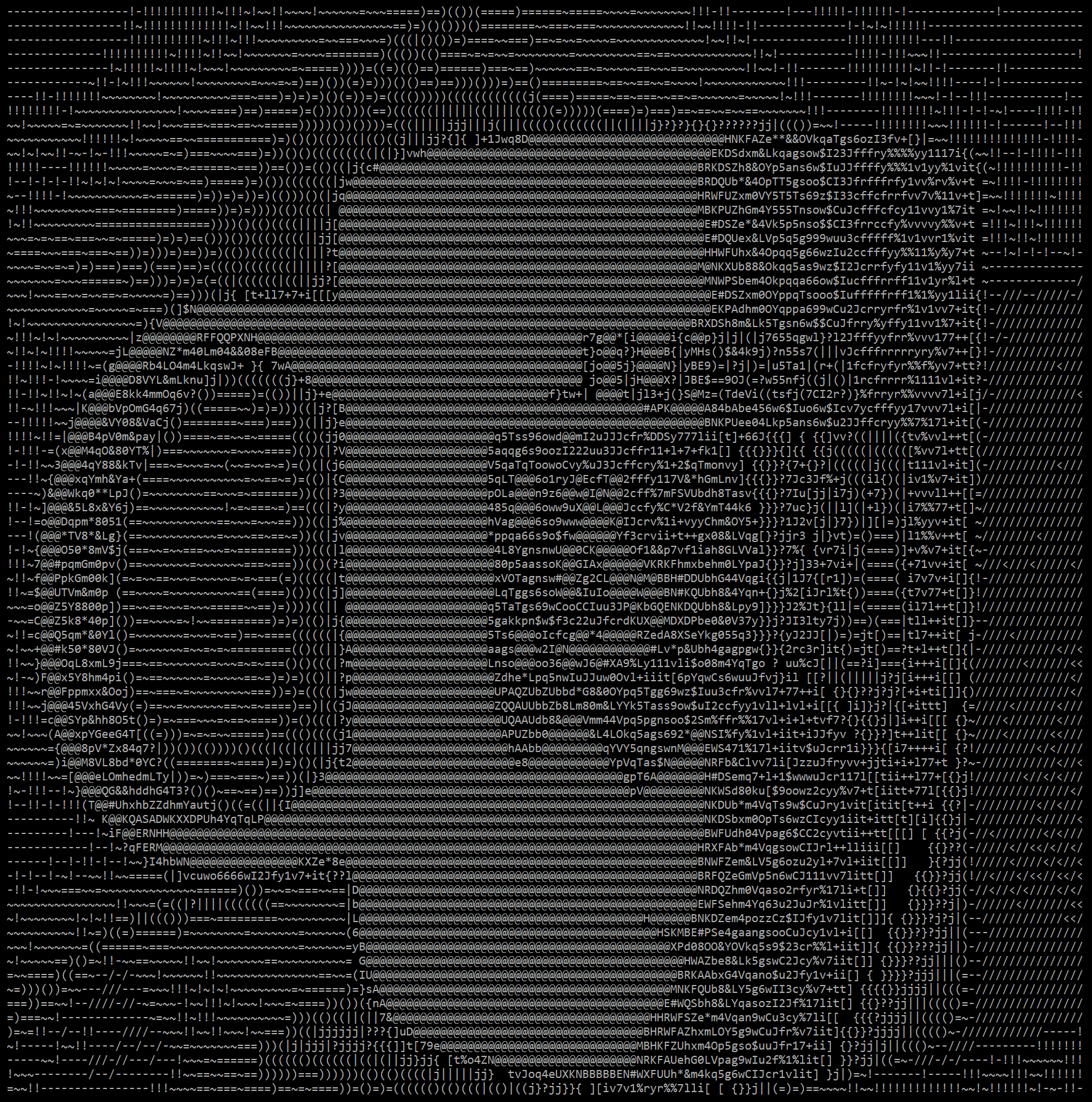

This is a black and white Camera Module, which has I2C to set/read registers and can be configured to use a single D0 data connection with a 24MHz synchronous clock line. Thus 4 lines is enough to interface with a microcontroller.
It sends 8bit grey scale values for each pixel. Natively it has a resolution of 320x320 pixels (105kBytes). Also it supports onboard averaging to a 160x120 pixel format, giving 19.200 bytes per picture.
I has automatic exposure by default.
Thanks to P2 Smart Pin Mode for Sync Serial and the great help I got ( https://forums.parallax.com/discussion/178022/synchronous-shift-in-with-external-clock-is-there-a-simple-example#latest ) the serial interface turns out to be totally simple, if you use "gated clock" mode to grab single pictures.
In my setup I use a dedicated I2C bus at ports 33+35. Serial picture data is port 37, Serial picture clock is port 39. In addition GND and 3V3 has to be supplied to the camera. Power consumption is low.
The demo code shows the picture with a ASCII character grey scale.
This is my coffee mug.

  • Thank you, @rogloh ! Your driver might come handy, depending on what I shall do with the picture, now that I have a stable way to grab it.
    Yes, what can we do with a BW picture 320x320 with P2? - Ideas welcome!

    The program above with SPIN Tools IDE needs 144 milliseconds to grab one picture320x320. This seems to be independent from exposure time.
    Picture160x120 takes 114ms, 8.7fps. I assume, that starting and stopping the stream is not so good for speed. Datasheet indicates max 30fps @24MHz.
    Angle of view of this camera is said to be 60° but my measurement shows about 45°.
