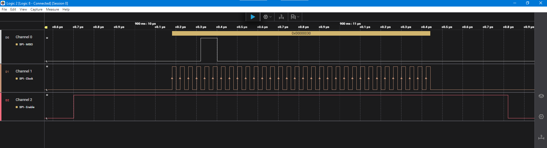

    In this demo I start up a background Spin2 cog and use smart pin sync_tx to simulate sending one 32-bit value (see screenshot from LA). used a set of jumpers on my Eval board to route signals.
    Note: the sync_rx function defaults to LSBFIRST so you may have to reverse your data bits before saving to the hub.
  • @JonnyMac said:
    Give this a try -- seems to work.
    Thank you very much!!!
    Christof

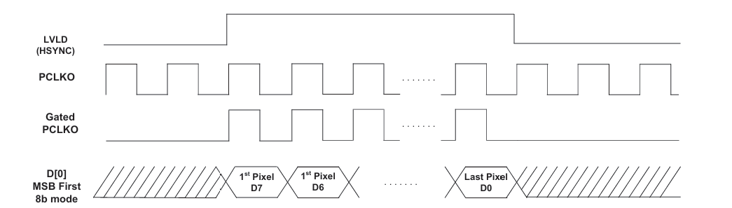

  • @AJL said:
    Hi Christof,
    While I don’t pretend to be an expert on the Pico’s PIO, after reviewing the code and the data sheet it looks to me like you are setting up to read on the wrong clock edge.
    That's odd: If I look at the diagram, I posted, it seems right to latch with falling edge. But the PIO code is different. Perhaps there is enough delay in the PIO?

  • AJLAJL Posts: 533
    The image sensor data sheet shows the data transition happening while the clock is low, so reading should occur on the rising edge while the data is stable. I don’t know where you got the diagram that you posted.
  • Christof Eb.Christof Eb. Posts: 1,597
    edited 2026-02-24 09:50
    The diagram is figure 6.8 from page 33 of the data sheet. Polarity of PCLKO can be set via register 0x3068[0].
    Perhaps I can try to measure with my oscilloscope, or just try out.
    In any case thank you very much for pointing me to this!
    Edit: OK, my 70MHz scope is a bit slow for this, but data transition seems to start with falling edge. Jep, reading on rising edge makes sense, whatever that diagram says.

  • evanhevanh Posts: 17,314
    edited 2026-02-21 22:44
    For some reason PCKLO frequency seems "only" to be 12MHz. (?)
    Yes, the datasheet is broken, use a fast oscilloscope to work out by experiment.
    PS: The actual timing info is on pages P47 and P48 of the datasheet, but its numbers are just as screwy as that diagram is. It talks about data latencies longer than the clock period, and inflexibly large setup and hold times that shouldn't even be listed since those are parameters for receive not transmit.
    There's no consistency either. The latency on page 47 even if subtracting a clock cycle (88 - 83.3 = 4.7 ns) is still larger than the latency on page 48 (31.2 - 27.8 = 3.4 ns). Doesn't make any sense at all.
