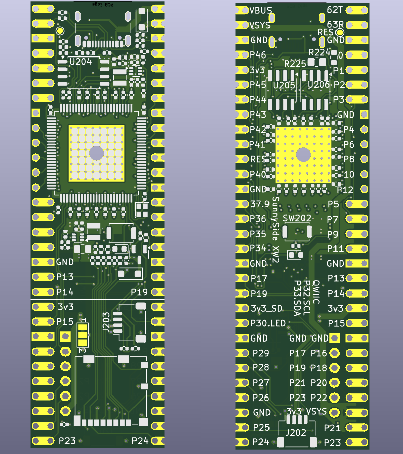

Sunnyside the FLiP compatible P2 module
SaucySoliton
Posts: 578
Great for breadboard use or as an upgrade for designs using FLiP or a DIP 40 P1. Will be slightly wider than a FLiP or DIP 40.
USB-C connector with data pins P62, P63. Reset signal on USB SBU pins. For now it would work with special prop plug with type C output. In the future we could have a native USB bootloader. I think an FTDI chip would fit on there if desired.
At the other end maybe a 4 pin JST for I2C. (QWIIC) If the PCB is 0.8 to 1mm thick then an edge connector for an HDMI cable is possible. Or another USB-C connector so the Sunnyside and Prop-Plug-C are the same board.
Power supply would generate the 1.8v from the 3.3v since the P1 only receives 3.3v. If used in place of a FLiP it would accept 5-9v from the appropriate pin.
Not routed yet, but I think it's possible with 4 layers.

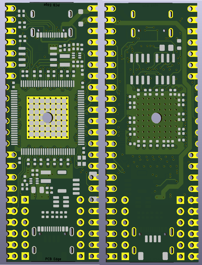

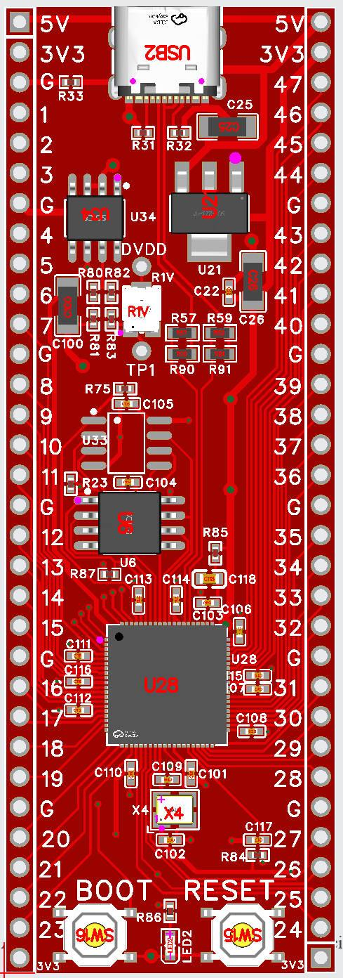

This is my take at a low cost P2 board.
Mostly Pi Pico compatible pinout. It's a bit longer.
Single sided pick and place (except PSRAM. Although overclocking might not be great with capacitors on 2 edges only.)
Breadboard compatible .1" through hole headers. I think it would be possible to bend some of the top pins to connect to the castellated edge and get all of the pins.
Uses the P2 internal crystal oscillator to save a few cents and lower standby power.
USB-C connector for programming. I think a native USB bootloader is possible. Until that happens, those pins can be used for the usual serial programming.
A second USB-C connector to program another board or connect to USB devices.
4 layer board without via-in-pad.
7 pins lost due to lack of space to route them. (Pins 0-3, 38-39, 47)
10 pins PSRAM (48-57)
4 pins flash (58-61)

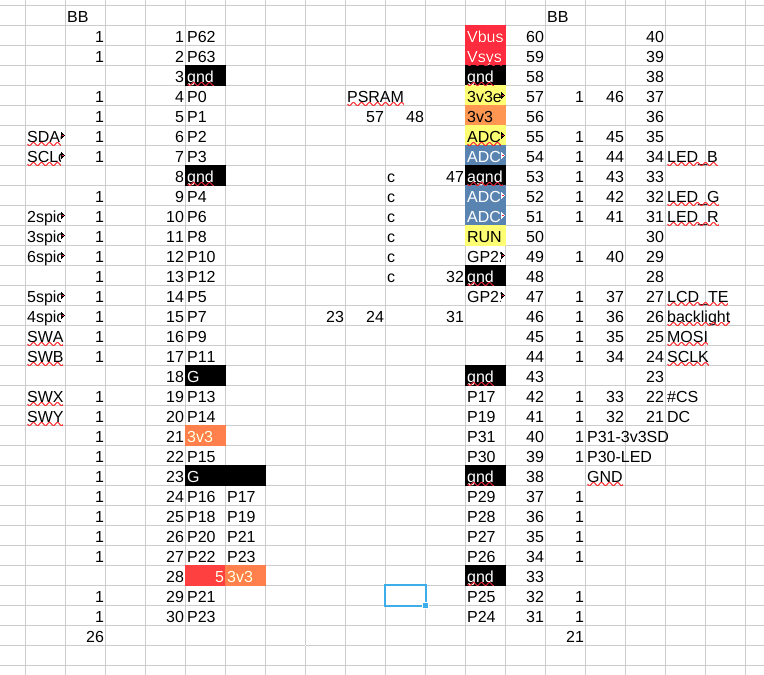

41 total GPIO, including P62-63. 29 on a breadboard, 33 castellated. (Pico has 26)
2 pins dedicated to QWIIC connector. (32-33)
2 EVAL connectors, 1 with 5v power
Pins starting with B are the inside columns.
I pivoted towards Pico compatible instead of FLiP compatible. But I still really like the Sunnyside name.

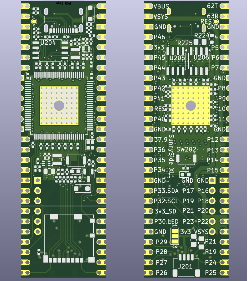

Gave up one EVAL header to fit the micro SD card. 4 bit interface.
Prop plug header could be attached to the board with some creative soldering.

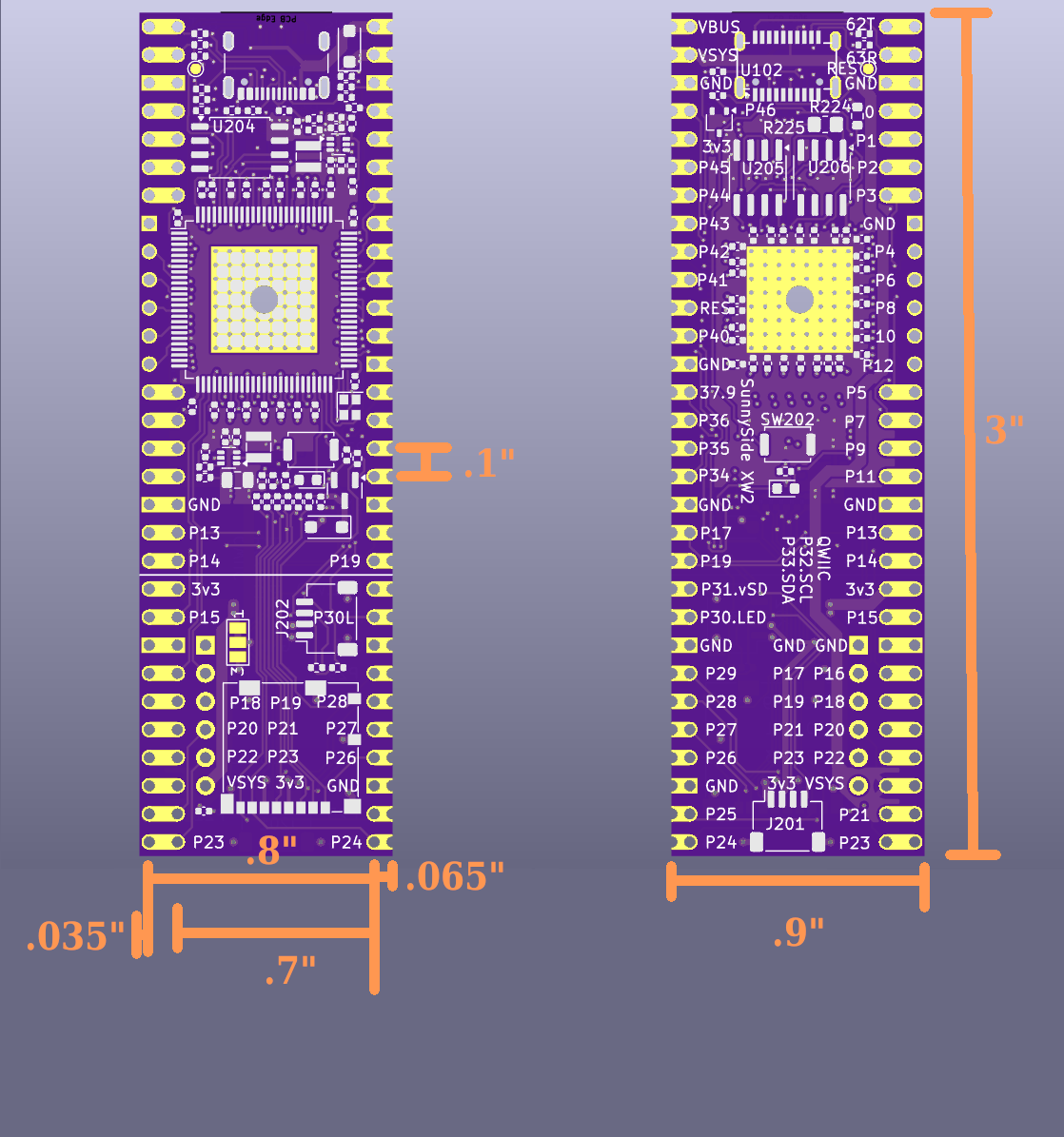

Is .1" inch pitch important? The through hole pins on the pico style are .7" apart. The castellated edges are not on a .1" grid.
Do you want the one with 2 EVAL headers (more GPIO) or the one with the microSD?
Do you want 16MB PSRAM? With a smaller flash chip it's possible the PSRAM could fit on top. I designed it so it to be a usable basic board with the top side parts only. I chose the large PSRAM chips so they could be added later.
There are a few things I'm not quite sure about. The bypass capacitors on the top are only on 2 sides instead of all 4 like the Edge. I added additional capacitors on the back side in case they are needed. I won't know if they are really needed until I build some of these. In practice it will depend on the clock frequency. Even 2 layer boards are fine at 250MHz. 340MHz might need a well designed 6 layer board. The boards I've shown here are low cost 4 layer boards.
The 6 small castellated rings, they might be too small for reliable castellation.
It's a native USB interface which will need a USB bootloader that does not currently exist. There is code for a USB serial device. Or a prop plug that outputs to a USB-C connector. It will be possible to program it using the DIP pins.

Oops didn’t realise the pitch wasn’t 0.1”- I would absolutely need that. Breadboard friendliness is essential in my case.

So basically "as many breadboard friendly pins as possible." The Pi Pico is fully breadboard compatible. The castellated edges are .1" pitch, but .826" center to center. Because the P2 is such a big chip I had to remove some of the through hole pins. I think I can get those 6 castellated pins to the breadboard with some creative bending and soldering of the pin headers.
I will assume you would like the P2 facing down so the silkscreen faces up.
Should I remove P4 to fit the prop plug connection on the dip pins? I already put a reset pad there so a prop plug header could be creatively soldered there.
I could extend it by 4 pins and break out the microSD pins. Would you like that?

That red board looks like the spacing between rows is 1.0". Not really usable on small breadboards. Well, I guess you could use half the pins.

If the P2 faces downward fitting a heat sink would be difficult, don’t know how much of a problem that actually is and having a usable silk screen with pin numbers would be nice too - difficult one.
Extending the board to make room for extra pins sounds great to me, I mean anything up to 63 pins will fit on a full size breadboard;-) The “P2-stretch”.
I don’t have any eval boards, I just use breadboard breakout boards for everything, as those will work with other platforms as well.
Heat-sinking the back side is far more effective. That's where the thermal pad is located and soldered to the PCB. James has even provided a decent cavity to solder a thermocouple right on the Prop2 thermal pad.
PS: On that note, James, I'd recommend the PCB space inside the ring of backside ceramic capacitors be left without solder-mask so it can be a good thermal contact surface for a correctly sized heat-sink shoulder.
Then still need to solve best way of holding such a heat-sink to the PCB though. That, I don't have any good ideas about.
All the P2 boards I've built have the soldermask removed on the backside of the P2. I forgot why I added soldermask on this one. Anyway, back to the old footprint that I got from the forum.

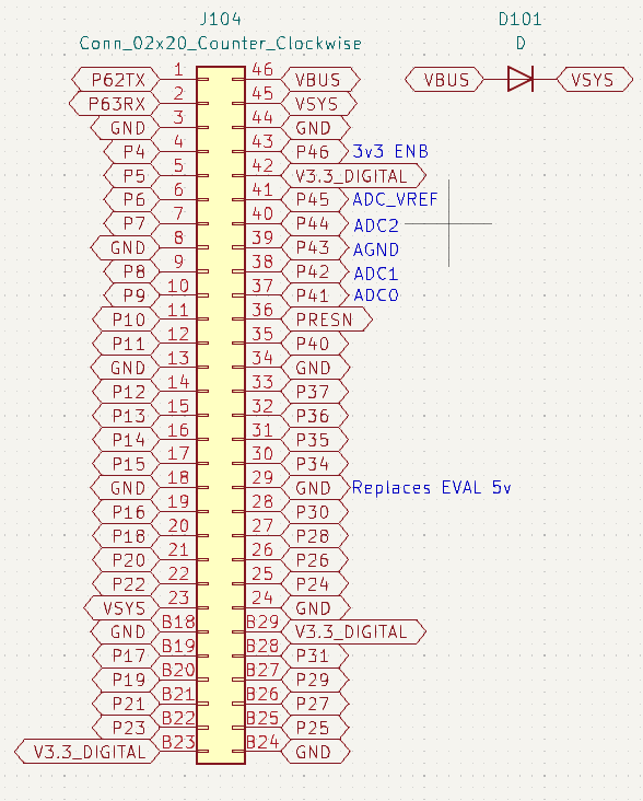

It’s unfortunate that P0-P3 are not on the headers, is there no way to get those? Having P0-P31 on the headers and a way to plug in a prop plug (even with a tiny connector) would be great.
Cool.
I was going to say no way for P0-P3. But, I thought that even if I can't get more pins that P0-P7 would be more useful than P4-P11 since we use groups of 8.
Board will grow to 30 pins per side. The castellated edge on the left will become through holes and move out to be .8" on center from the right side through holes.
I did a test route for P0-P12 and it was necessary to interleave pins to make it work. Some other pins are interleaved because they are part of an EVAL header. The inside pins of the EVAL header are assigned wherever they can fit.
Excellent ideas, P0-P31 are there, and even an eval header - and good to have the through hole pins on the left now!
P31 is the SD power control. That is routed out because I thought it could be useful to have a switched power output. The MOSFET could be jumpered to use P31 as IO. Or if capacitance must be minimized it can be jumpered to P34.
The QWIIC connector uses P32-33 which are not routed to DIP headers. Pins 37-39 are tied together. 47 breadboard IO pins plus 2 on the QWIIC connector.
