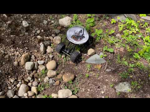

Hello fellow Forumistas! I am back with another four wheeled robot build. This time with somewhat realistic goals!
Features:
  • Redcat Racing Everest 1:10 Scale RC Rock Crawler
  • LoRa Radio 915mhz (Heltec ESP32 with OLED) DIY 915mhz antenna
  • 5.8ghz video and audio link
  • Ultra-low lux camera
  • Propeller 1
  • SK6812W LEDs
  • Expanded PCV platform
  • Portable Control Station, video link and LoRa link over USB to any computer
I chose the RC crawler https://www.redcatracing.com/products/everest-10-1-10-scale-crawler-2-4ghz because it is slow and can handle terrain well. There is an easy conversion kit to four-wheel steering.
The plan is to revisit building a semi-autonomous rover that can be left outside for long periods of time. Now that I have an area to do such a thing, unlike my last, “we’ll just leave it on park land indefinitely and hope for the best” solar powered rover.
I am at the point of having something worth posting. We do not need solar power although I am toying with the idea of wireless charging via a solar powered dock. As is, with the right power management this could spend days out in the woods.
The expanded PVC platform and matching acrylic dome are a work in progress. Before I get to that I would like to see how much space I need. The Propeller Project board will likely be replaced with a Prop Mini or Flip. The camera needs a pan/tilt mount. The antennas need better mounting.
I have driven the robot into the woods and covered a 3 acre area exploring during the day, and once at night during a thunderstorm. All from the comfort of my alternate home office. I find it highly entertaining and much better than anything on TV.
More to come, it took me over a week just to write this… I know my priorities are out of whack!
Here's my DIY antenna. If you're wondering why the soldering is so bad, I did this with a TS80!!
This is how the ePVC attaches to the chassis. This is just a prototype so yeah, it's a little sloppy.
Here we have the Heltec board mounted to a Propeller Project board. There's a small perfboard holding a 5V supply for the LEDs, and a FET to control power to the video transmitter. A tiny little Foxeer low lux camera, and the 5.8ghz video transmitter, with built-in microphone.
It is starting to look like a robot.

  • Video of rock crawling action. Next up, work on video antennas and repeaters. The video signal is poor because there is no line of sight. Instead of running wires outside of the house I'll just repeat the signal on another channel.
