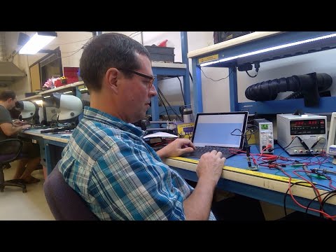

    Might it be worth Fedexing a chip to Peter so he can test too? He knows the pcb and has parts.
    That sounds like a good idea...
    They are about to place parts, so if they are 100% certain of pin 1, maybe send Peter a placed board ?
    Correct Pin 1 verify, should be checkable with a uA meter on RSTn to test the pullup, when powered.

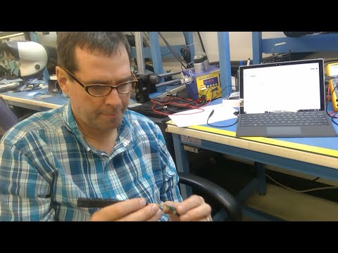

    1. A lot of heat was supplied to the chip when soldering the ground pad. Could this have damaged the chip?
    Not to mention cracking the die with the mill-the-board approach. Surely a IO substrate diode can confirm GND connection ?

    If you are still puzzled about 'Chip backwards' - why not simply measure the Pullup on the RESET pin ?
    ie GND RST thru a uA meter. A 50K pullup, will show 66uA
    The XI should not have that.
    For GND TAB checking, measure the substrate diodes, to the GND plane.

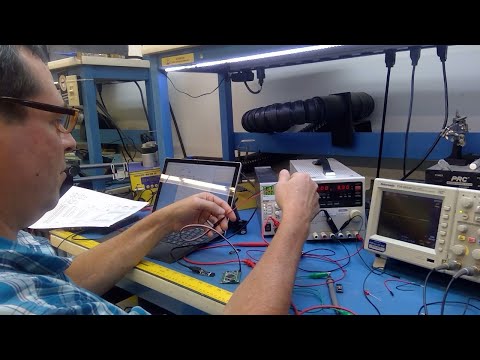

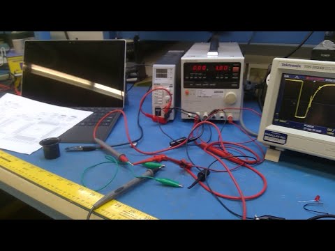

    For a more complete test, I'd suggest a 5R in the ground lead to the PCB.
    Connect a 1:1 scope probe across that, and you get 50mV drop at 10mA. If it goes over 50mV, lower the resistor.
    Ramp Vcc core, with RST low, and watch Icc
    Then pulse RST, and capture the current profiles (trigger on RST), which should show OSC / Loader stages.

    Yes, i have all the parts and didn't have any problems with simple hand assembly plus i have used chips before with large thermal pads so i know what to expect. I'd let it reflow in the oven but otherwise I'd use a big fat iron and some wetting solder if i had to encourage it.
    Yes, reflow in oven sounds best, (even better with a paste screen)...
    I'm a little worried about the uneven thermal stresses of the point-heat GND tab approach Chip is trying, on the delicate samples.
    Before hitting the part hard like that, I'd first meter the IO's substrate diodes to PCB GND plane, to check if it is really needed.

    I'm not following the inverted reset issues, as the PCB has a CAP in the base of the Reset Trx, which makes it edge activated ?
    ie a narrow pulse will reset, just on different edges. (few ms difference)
