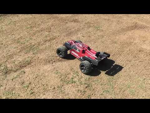

  • I had a close call with 12V and my only Pi. I ended up powering it on a separate battery with USB 2.1A output.
    The Prop mini was perfect for this. Idk if I posted this video here, I thought I did but can't find it. I had fun interacting with the truck locally. The remote side is great if you're remote. After an hour of interacting with it via TTS, no computers, open field, I forgot about internet. The truck had brains. The Pi USB microphone did surprisingly well in the wind.
