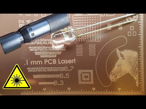

He's not using a raster approach in this year-old video, but his willingness and ability to modify laser parts and so on reminds me a lot of you (or vice-versa).
